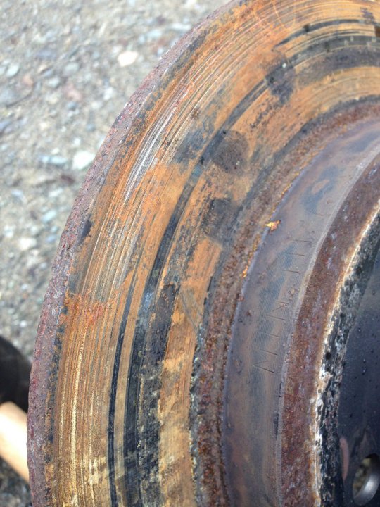

    After the road trip I washed the car and noticed the rear wheel covers had a lot of rusted brake dust residue on it. Then I realized the rotors had some pretty deep scores and the rear pads were completely worn. So again I asked my favorite mechanic mr. google and found out that this is known problem with another TSB...

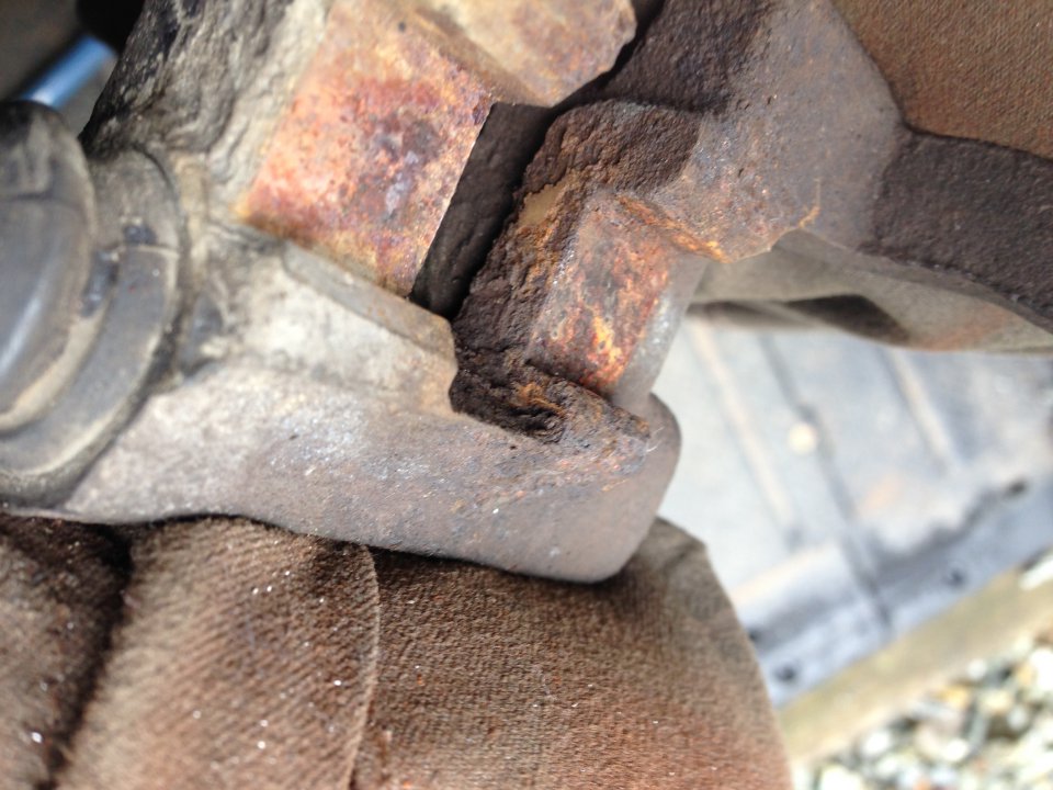

    After reading any post I could find on the uneven wear I couldn't really find any description of what causes this problem. This post is my experience with this problem and some discussion of the possible reasons.

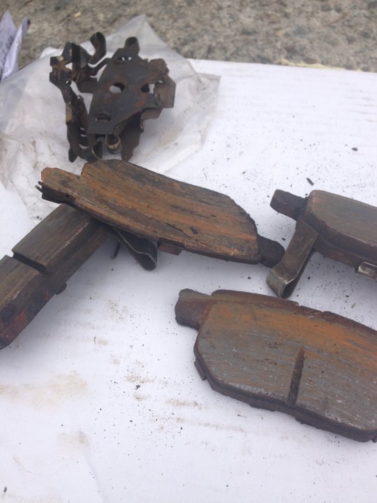

    What I found was the outer pads were worn down to the metal and the inner pads were maybe 50% worn, but I had no idea why it was happening. I was expecting to get 200,000+km out of these brakes like the GenII seems to get.

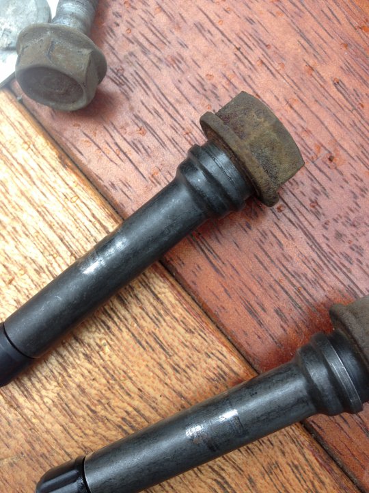

    I then pulled the caliper slide pins out and cleaned and regreased with high temp brake grease. They were in great shape and there was no problem sliding.

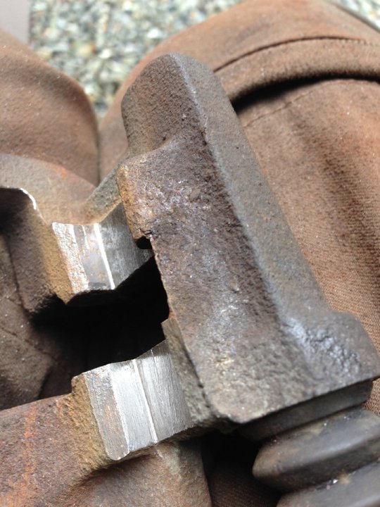

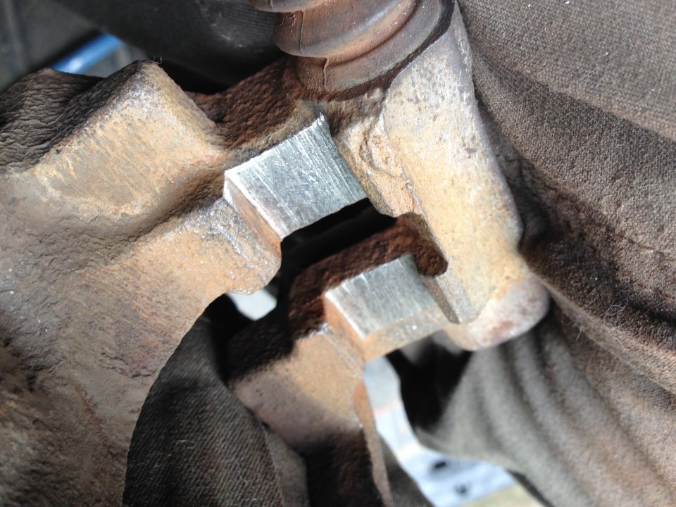

    Since I didn't find any problem I started putting everything back together. I unwound the caliper piston with a universal tool I bought from the parts store. When I put the clips and pads back in I noticed they were very difficult to position properly and move back and forth. I couldn't get the pads to slide next to the new rotor. Then I noticed what I think was the problem. There was a bunch of corrosion in the dado part of the caliper. I filed all the corrosion out and put the pads and calipers back together. I also put a bit of high temp brake grease in the dado to hopefully stop anymore corrosion. I put the calipers and pads all back together and everything seems to move nicely now.

    I attached a bunch of pics that show what I was trying to describe.

    The pins were sliding smoothly with no problem, but I cleaned off the grease and put substantially more grease on.
    I am positive what caused the caliber to jam and cause the pads to wear unevenly was the corrotion behind the metal clips.
