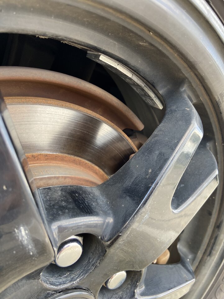

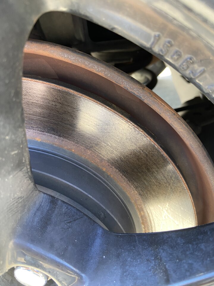

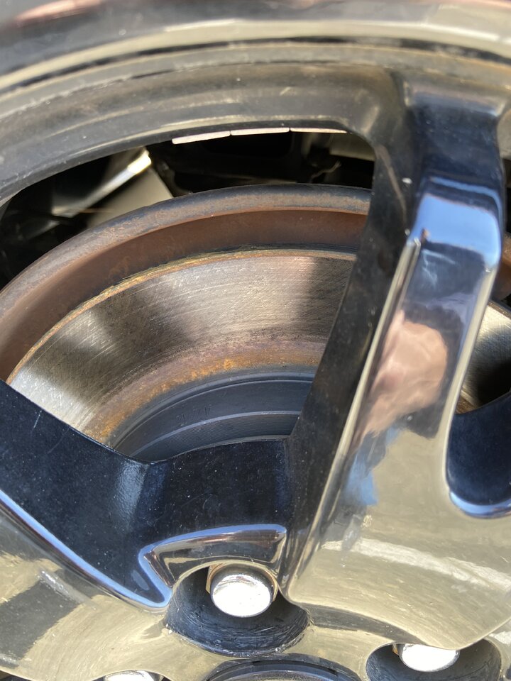

    Did the rear brakes on my 2012. I cleaned all the rust off the bracket. Properly lined up the caliper. Greased sliding pins. I used advics pads and rotors. Should I take it back apart? Anything you’d look for? Both wheels spin free and are not dragging, also no brake noise or shudder.

    In my opinion -- this is just something that happens with hybrids. I guess the brake pads don't get enough use and the rotors corrode faster than the pads can keep them smooth. If it causes poor performance, replace the rotors.
    I've seen this in a Prius and also on my Accord Hybrid.

    I guess my main concern is my old rotors were clean and didn’t have these grooves. I’ve also used neutral braking multiple times trying to clean it up. It helped a little but not much. These only have less than 1,000 miles on them too.

    Did you compare the shape of the old and new pads? Maybe the aftermarket pads are not sweeping that rusty zone? Or the rotor dim's are different?
    It's never occurred to me to use anything other than the car companies products, over the years, keeps it simple(r).

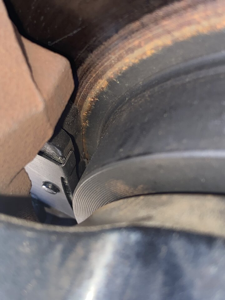

    The rotors are advics which is the manufacturer for the rear rotors on the Prius. It was exactly the same. Also the pads I used to have was Wagner oex. The new advics pad goes basically to the painted black line.

    This is well within normal, you've been condensing and rusting on the edge, due to prevailing weather, colder temps, different humidity, different driving patterns. Not a big deal. Not going to change braking a noticeable amount. Still going to get good wear and life from the rotors and pads. I've seen 2nd gen with 250K with original pads and rotors look just like this. This mileage is normal unless you commute on a long steep hill every day.
    A guess to what's happening. Overnight you get rust on the entire face. Next commute wipes the rust, but the inner edge rear gets the least force and the least heat so it doesn't always clean all the rust off and it builds/ accumulates sooner there because it's not fully cleaning every drive

    road salt? A humid cold wave. Something made them rust. At this point it's still just cosmetic

    Yep it's normal with after-market pads and rotors but I am surprised you don't have noise from the surface rust on them.
    Personally, it they are, still, working good I would just keep an eye on them and replace them with Toyota OEM pads/rotors the next time. (I just replace all 4 in my 2014 Tundra and they actually didn't cost all the much more than the Gold ones at Auto Zone but the quality is clearly head-and-shoulders above!)

    I thought I was doing good by using advics which is an AISIN company. The rotors are completely the same as what Toyota uses and sells but the brake pads are different, closer to their budget line? But even then slightly different from the pictures I saw online.
    I may try and just replace the brake pads and get the new shim kits as well. Do you think I could re use the stainless clips or get oem anti rattle kit from Toyota as well.
    Here’s a picture of the rotor before I replaced. I’m at 216,000 miles btw. Original rotors but this will be my 3rd set of pads. Toyota used aftermarket rear pads (Wagner oex) around 140,000 and I’ve just never liked them and they finally got worn down enough to justify replace (4 mm).

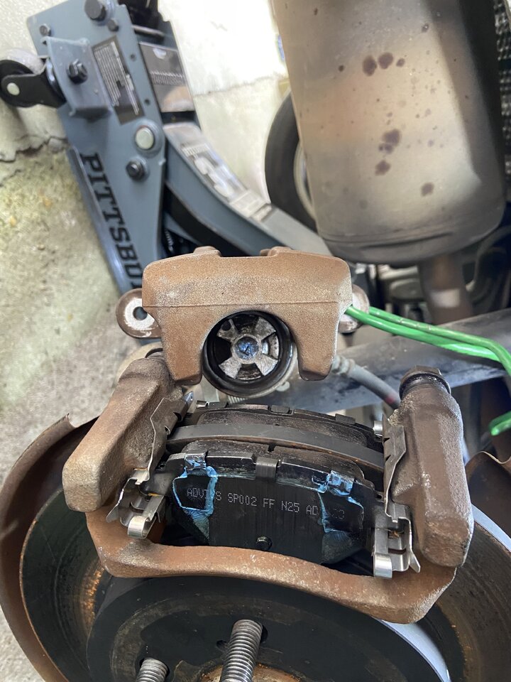

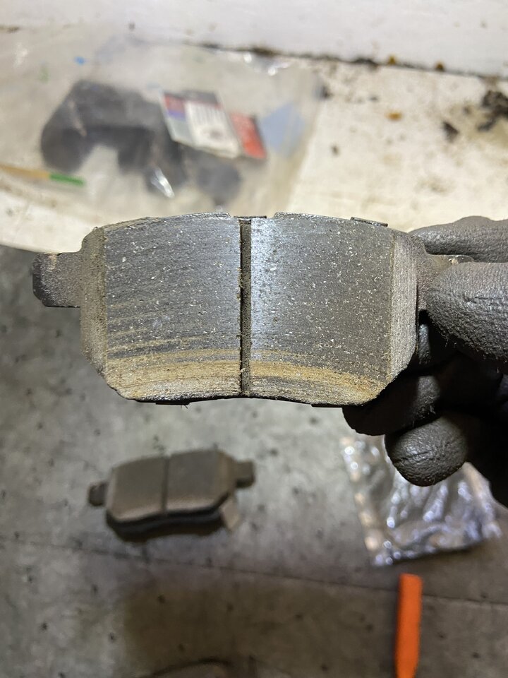

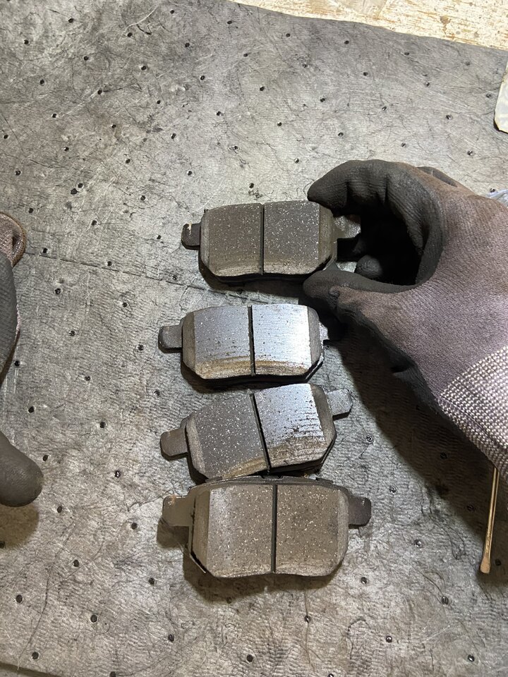

    Switched over to Toyota pads today. Any ideas as to what would cause this uneven pad wear? The caliper was lined up properly when I took it off.

    Looks like they are taller than OEM pads.
    You should never go cheap with brake parts.

    When I hear rear brakes and uneven wear my first thought is the pin on pad backing plate has gotten out of the piston face slot. Still, aftermarket rotors and pads could be factors as well. Original rotors still on hand?
