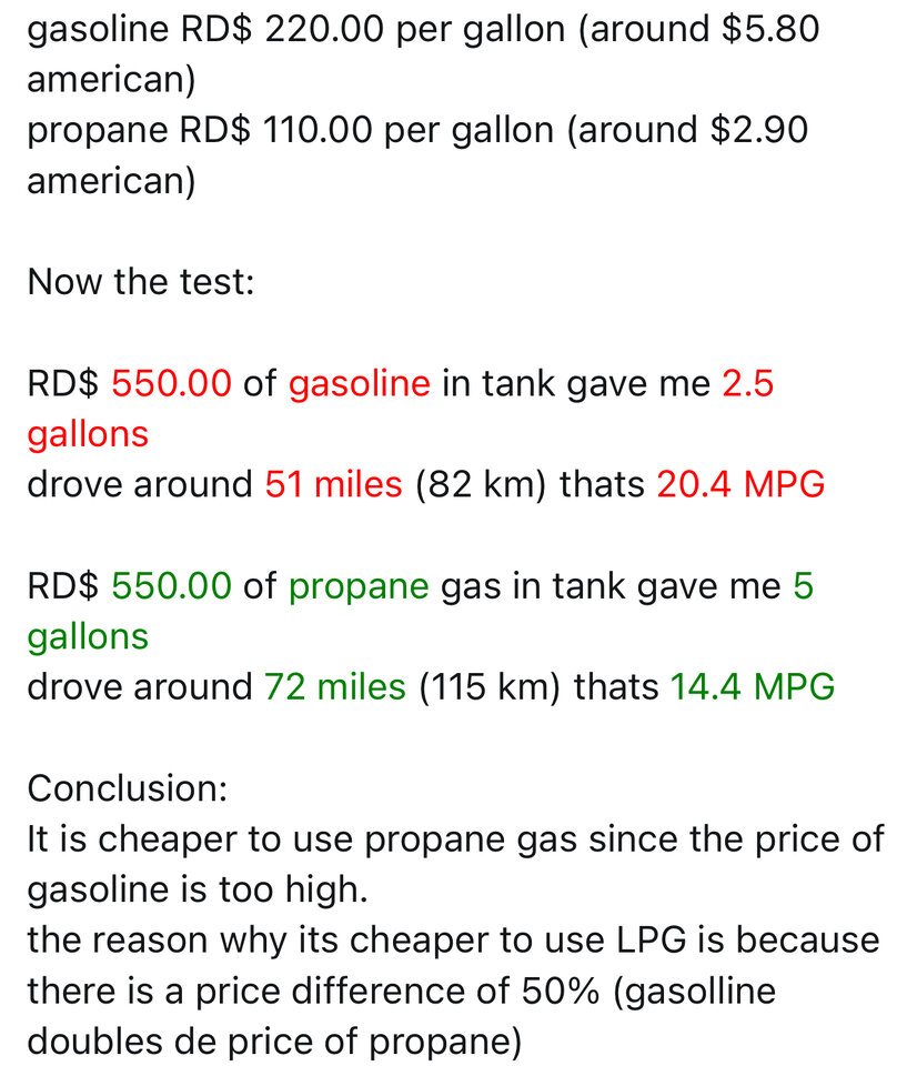

    Per afdc.enery. gov
    • Propane contains 10-15% less energy per gallon than gasoline. This means a vehicle might see a 5-10% reduction in mpg when switching from gasoline to propane.
      Octane Rating: Propane has a higher octane rating (104-112) than gasoline (87-92), which can allow for more aggressive [optimized] engine tuning and potentially improve fuel economy.
    A converted vehicle is usually setup for bi-fuel meaning it can switch between LPG and gasoline.
    A Prius with its knock sensor will take advantage of higher octane. The value of higher octane gasoline in the US is negated by the price of high octane fuel.
    Here is a first hand Dominican Republic non-optimized experience:
