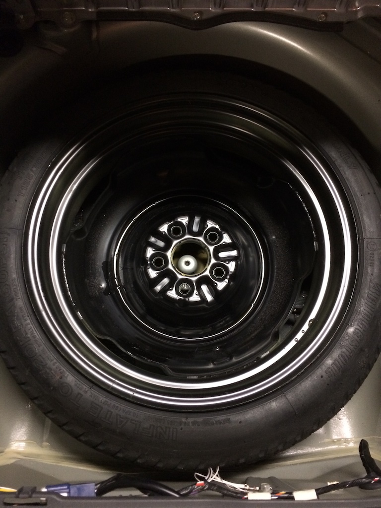

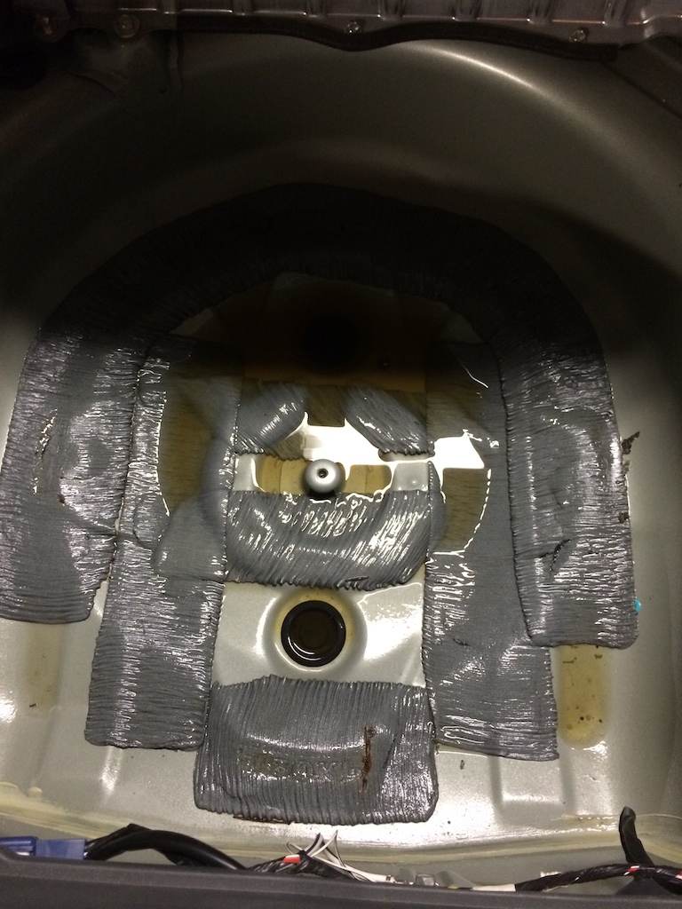

    So, I've been searching for a smell in my Gen II Prius for the last several weeks. I'd think I'd found it, then come back after the car would sit in the garage overnight, and it'd be back. Smelled a bit like sour milk or urine (some of you may already know where this is going). Since I have a 5 month old, I figured maybe there was some smelly burp cloth, or something... but I'd pulled all that out.
    So, yesterday, I figured "maybe it's in the compartment under the truck". Open it, and WOOF, there we go. So, I pull everything out of there, and figure I got it. This morning, it's back. Son of a! So, I think "maybe it's under the bin". I pull that out to expose the spare, and low and behold, I find yellowish liquid. Hmmm... that looks like uncured epoxy resin. Smells a bit like it too.
    Now it all falls into place. I was rear ended about 6 months ago, and they did some repairs. The repairs look a bit like metal "patches"... which I'm guessing are saturated in epoxy, then "patched" over any cracks in the body work. All told, I'd guess there's maybe 1/8th to 1/4 cup of liquid... and it's on the backside of the spare, as well as pooled in the space.
    So, questions.
    1. Should I just take it back to the collision center (which is owned by the dealer that I bought the car from) and tell them to clean it up? Or should I just clean it up myself and file a complaint?
    If 1, do we think it could have damaged the rubber of the spare? Or if 2, what's the best way to clean it up (just lots of shop towels)?
    At this point, I'm planning on taking it in tomorrow morning... But I'm curious what people think.
    Thanks!

    I haven't thought of asking for a detailing, but good idea. I did think about calling the insurance company should they refuse.
    Attached are pictures. And yeah, sad they don't relay the smell... [​IMG]

    That doesn't really look like uncured epoxy to me. Also, epoxy resin is fairly pricey so it's unlikely that they'd be throwing it around like that in your trunk for no good reason.
    Just going by the photos, it looks more like a corrosion inhibitor product to me. It looks like they spayed it with some product and it has gradually run and pooled in the tire well. Fish oil based corrosion inhibitors sometimes behave a bit like that.

    Just FYI, I don't think those "patches" are patches. Mine has them and so do the ones on Google Images. They're probably for sound deadening.

    Ah, okay. So, feeling the liquid, it's both watery and oily I'd say. So not sure. If water got in, there is clearly a leak from the repair work done. I've never even exposed the spare before, so dirt in that area should be non-existent. But I guess the tire sitting in liquid would certainly lead to a smell. :/
