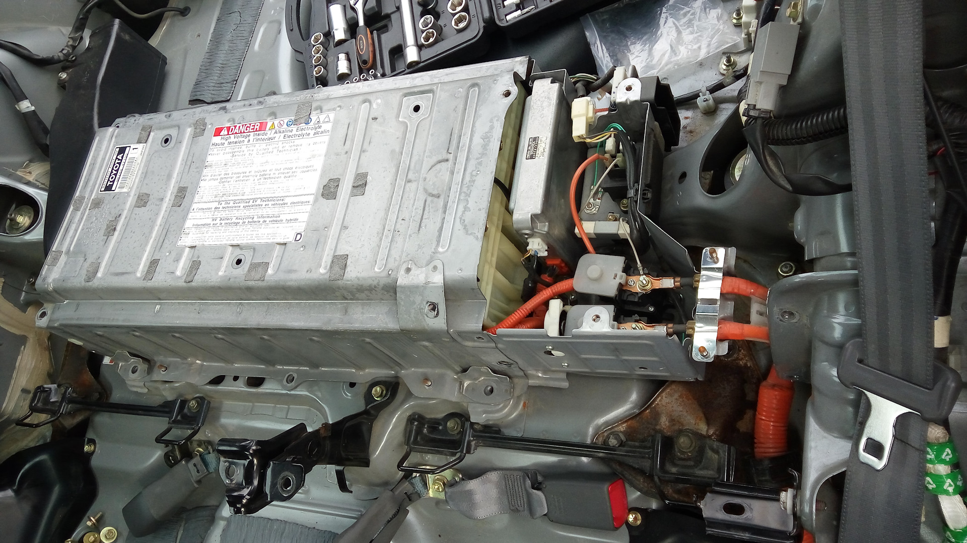

    The thin metal strip that sits across the cables from the HV battery.
    I found several cautions regarding not deforming it. However, the marks from the bolts indicate it has been swapped at some point.
    I have a NewPriusBattery, and the Prius threw a voltage isolation fault, p0612. I noticed some discoloration and before I got crazy(er) and tear the entire battery down I thought it would be good to know which way is up?
    the part has two curves, each curve has two very small tabs that I believe are supposed to go down
    However. When I pulled it off, it was the other way. When I read the caution about it being a possible source of that fault, I went to the web, and eventually here. I have searched but cannot find an schematic, diagram, or even an image of the part much less its orientation
    Any help would be very much appreciated

    The plate on the outgoing high-voltage orange wires?
    It is important not to touch the metal crimp terminals with this plate. If you touch it, there will be a large energy explosion in this place when you turn it on.

    Correct it should go down, the orientation of that plate/bracket is actually counter-intuitive. The photo in post #4 shows the correct orientation (down) as does the attached image (although not extremely clear) of the orientation.
    I hope that answers your question.

    Certainly, it should not touch the metal ring terminals that are crimped at the very ends of the inner wires. That Would Be Bad.
    The metal crimped ferrules on the outer cables passing beneath the plate, of course it touches those. Those are shielded cables and those ferrules are crimped on the shields, and contact with this plate is exactly how the shields are to be grounded.
