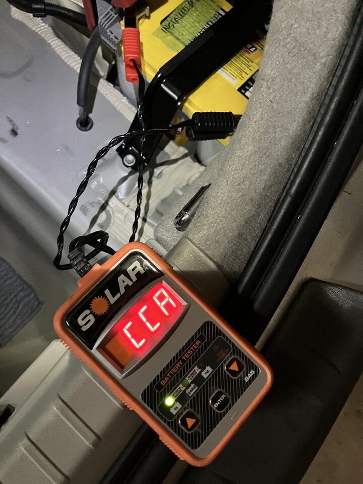

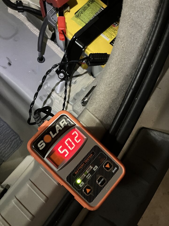

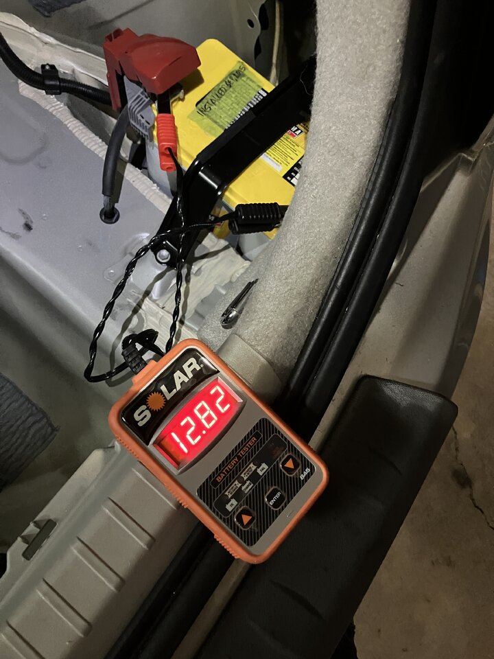

  10. Mendel Leisk
    61,574
    42,362
    I’m using a Clore Solar electronic load tester occasionally, current iteration I believe is BA9. Seems to be more readily available through Amazon.ca than .com, but with latter I see what appears to be the same unit, maybe just different naming convention?
    years back I watched a YouTube review, guy comparing various test methods, and the Solar brand tester, impressed me. Can’t find it now, maybe later.
    recent test pics:
    (second and third pics are tested CCA and voltage respectively)
    #10 Mendel Leisk, Dec 17, 2025
