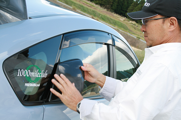

    Or you could try ramming air into the vent with a mod like this.
    There's another photo showing the rear window closed as he offers up a duct on the outside, but all other photos show the rear window open, so I have no idea it it should work.
    Here is his explanation on page 2 of the article 東京~熊本1600km無給油チャレンジはかなりの忍耐が要りました | 由良拓也/今井優杏の「あなたの愛車教えてください!」
    "Oh, yeah, and then I have a very geeky thing to the ventilation holes to cool the battery, attached to the inside of the rear door on the Prius. It directs the airflow there. I made it with the carbon ducted and inset in the rear window. This is also avoids scratching the outside of the car." (combination of google translate and some guesses.)
    Though this would probably be noisier than the fan.

    For the extreme hyper-milers this mod is a must.
    The concept of the external forced battery cooling is great and ingenious.
    But to implement this mod, the rear passenger window need to be modified or replaced with something like lexan.
    I would replace the small triangular rear window to accomplish similar task with less intrusion to the passenger area.
