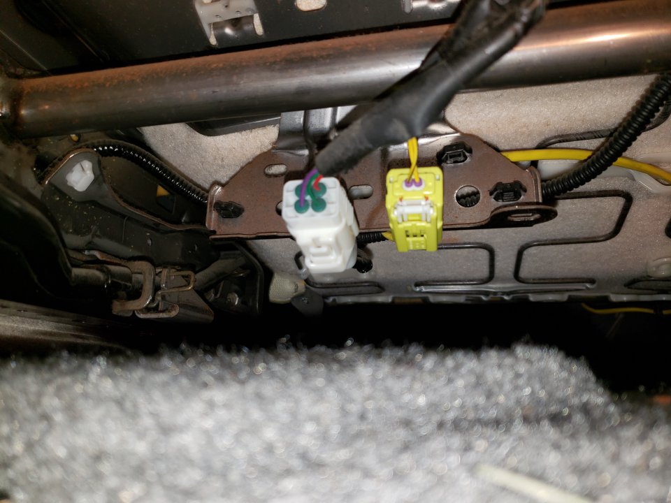

    I have the 2 following electrical connectors on my non-power 2010 Prius Base's driver's seat (Canada) shown below, looking from the driver's footwell:

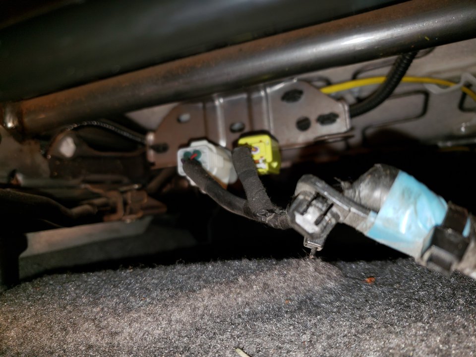

    Below is the same angle but showing more of the wire harness coming up from under the carpet, which looks like it is holding extra unused wires within the blue tape.

    My 2 connectors look identical to the middle (4 wire, white plug) and right (2 wire, yellow plug) connectors. Does my car have the wires to power the third power seat connector (3 wire: white plug) on the left?

    Did you ever find solution to this question?
    I just pulled the non electric fabric seats out of my 2010 prius and would like to replace the electric seats out of my totalled 2010 prius.
