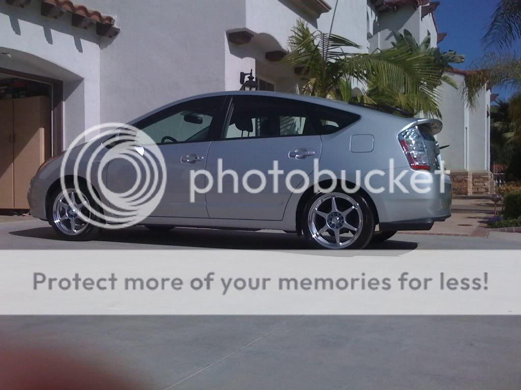

    Just thought I'd show the wheels. Yes indeed it does reduce the mpg a bit.. But the handling and added stability are a plus.

  11. Steamboatsig
    Steamboatsig Member
    Jan 3, 2008
    337
    2013 Prius Plug-in
    Kingprius,
    Your Prius looks niiiiiccce. I like it alot.
  12. F8L
    19,011
    4,081
    Grass Valley, CA.
    I agree!!
  13. kingprius
    kingprius New Member
    Feb 6, 2008
    Thanks guys. I figured a little gas mileage sacrificed is a good tradeoff for having the car be more surefooted. I actually ran 205 45 17 instead of the 215 45 17 many put on. That way I kept the weight gain at a minimum... The stock weighted at 35.5 lbs with tires. The new combo was at 37.5 lbs... So the gain was minimal. The major contributors were two things:
    1. My right foot... :D
    2. Tall ratio created by bigger wheel/tire.....
    I think the latter was more since the overall taller gear ratio produced by the bigger wheels actually slow down the vehicle more...
    Another thing though was that I also used forged lug nuts to further negate the weight... I know the stock ones weight probably triple of what the forged lug nuts were... But I didnt weight them....yet... lol.

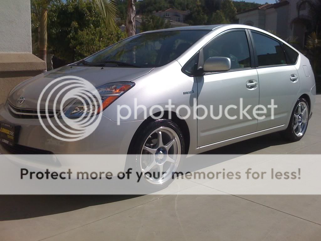

  18. 911turbox50
    911turbox50 New Member
    Mar 24, 2008
    26
    Chicago, Flagler Beach
    pic of my new rims...let me know what you think...
  19. ryanj023
    ryanj023 You Mad?
    Mar 28, 2008
    52
    Portland, OR
    fresh! [​IMG]
  20. patsparks
    Jul 12, 2007
    10,664
    567
    Adelaide South Australia
    I am very impressed, that looks very good. Tempted to fit 17" wheels at the next tyre change.
