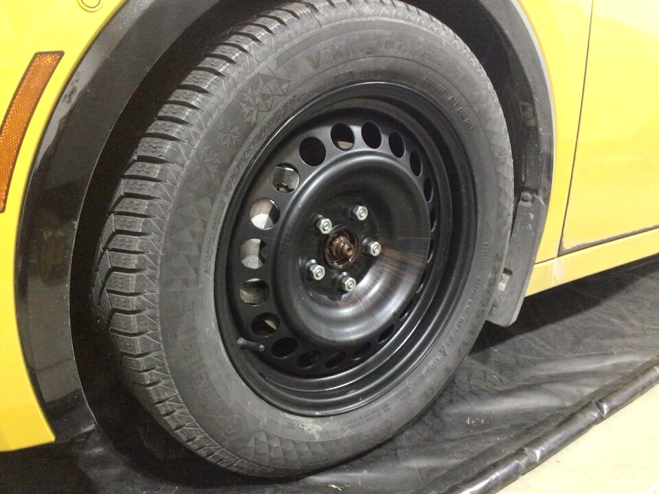

    Teez would you like to trade for brand new snowtires /wheels not driven on
    From dealer DVNT 225 55 17 7”steel wheels 5 114.3 60.1
    Winter Wheels Custom-Designed to Fit Your Vehicle | RWC Wheels
    my wheels are from this company
