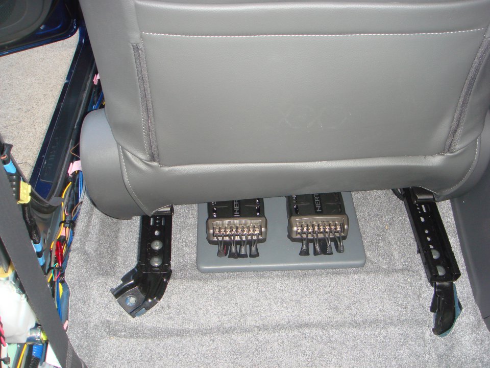

    Amp and speaker upgrade should give the desired results although I am not familiar with the specs of your factory HU. From what I understand the 2013 might not be a good candidate for HU replacement do to vehicle interfaces incorporated. My opinion is scrap all the old speakers "including the tweeters" with components up front using active cross-overs with required wiring changes and coax in the back. I too have a 2010 Prius II that was heavily modified linked below.
    frodoz Stereo Upgrade | PriusChat

    The cross-overs come with the speakers and are tapped for frequency separation, gains are tuned at the amp. I do not know what size Squawker/Tweeter the 2013's have, but 3" was the largest my 2010 would hold in that position. Look at my linked Album post #3 for my recommendation. 2 piece components up front are less invasive (no hole in the A pillar). I put my cross-overs under the drivers seat and amp under the passenger seat. I did go high end on my install so you have to set a budget before deciding on which components.
