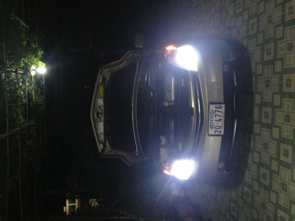

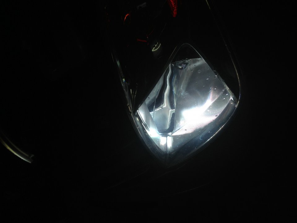

    After months of researching and foruming, I made a satisfied decision to upgrade from Halogen to aftermarket HID Bi-Xenon which is really great in color and high visibility at night.

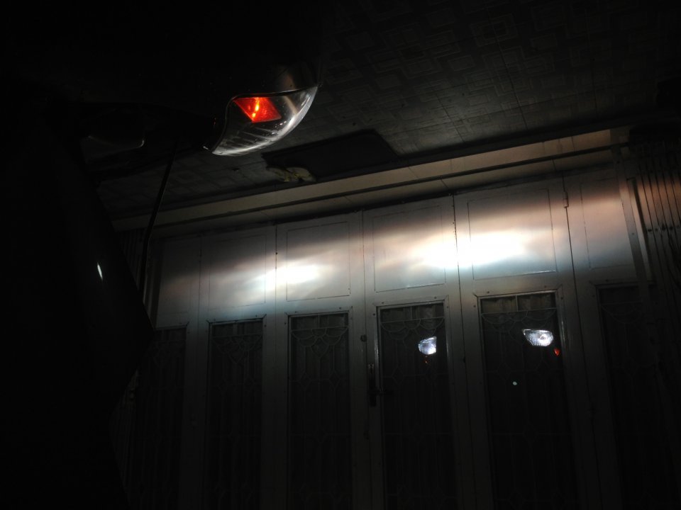

    Moreover, behind Halogen headlight there is a 8mn bolt where you will use your hand or 8mn wrench (remove the black plastic cover over bumper to make more room). Twist it Clockwise to lower and Counter Clockwise to raise headlight.
    I aimed mine relatively low because my intention is for a great looking light, high visibility and not blind on-coming traffic and yeah I'm so satisfied.
    Hope this is helpful for PC member who look forward to do the same thing.
    ***I couldn't find where to adjust attached pictures correct, so it goes upside down!

    Thank you for your information on headlamp adjustment. However for most vehicles in other countries the system is very different.
    The bolt you point out is not there but an electric motor takes it's place enabling the lights to be adjusted from the inside of the car or automatically. The is an override adjustment but this is done by turning a small gear wheel with a special tool (a suitable phillips screwdriver will do).
