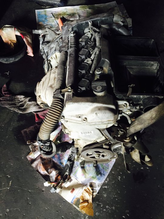

    Pat, I said "jacked up." I drove this car for 418 miles before it left a drop of oil on the driveway.
    This is on the back of the upper oil pan impossible to see without elevating the car. Also I'd know it if I was missing a connecting rod. In fact now that I can see in there they all look pretty clean and at accounted for hahahah!!!
    Can't imagine somebody going to the trouble of rebuilding a rotating assembly and not replacing a punctured pan that cost $100 from a scrap yard.

    Sounds like a nearly impossible area to get damaged by running over something, etc., though. :confused:
  8. Cory151
    Cory151 Member
    Mar 3, 2012
    102
    27
    Las Vegas
    I was thinking the same thing actually, but the metal is clearly pushed in not pushed out.

    The motor is officially out.
