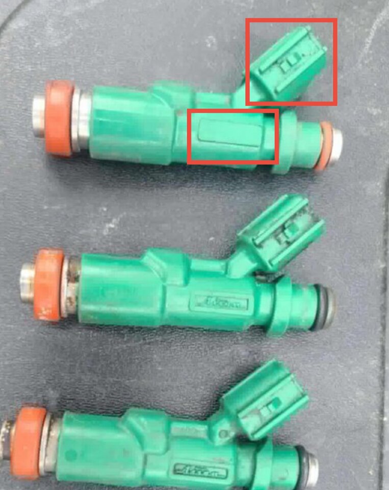

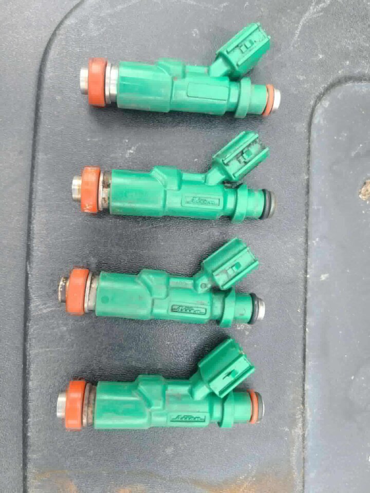

    They're the same color, but upon closer inspection, not the same.
    One set has a brand name and the other doesn't. More importantly, one set has
    a sort of conical plastic "hat" above the top O-ring. Haste, panic, and sketchy close-up eyesight.
    Also, one set is numbered 1 through 4. I don't know why or if it matters.

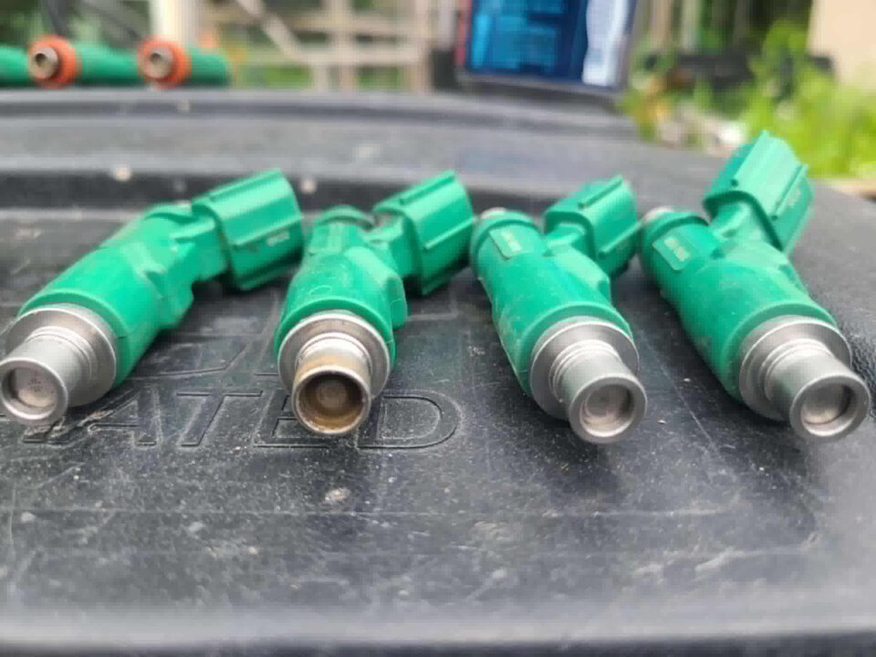

  14. Tombukt2
    Tombukt2 Senior Member
    Nov 29, 2020
    13,875
    2,521
    Durham NC
    Flip them over let me see the holes that do the squirting .
  15. Duncwarw
    Duncwarw Junior Member
    Dec 6, 2017
    Capital Region, NY
    One set...
  16. pasadena_commut
    pasadena_commut Senior Member
    May 2, 2019
    3,071
    956
    Southern California
    Top to bottom, right side of injectors:
    orange o-ring, long metal extension
    black o-ring, grey washer or short metal extension
    black o-ring, long metal extension
    orange o-ring, black washer, very short metal extension
    No two the same. WHY????
