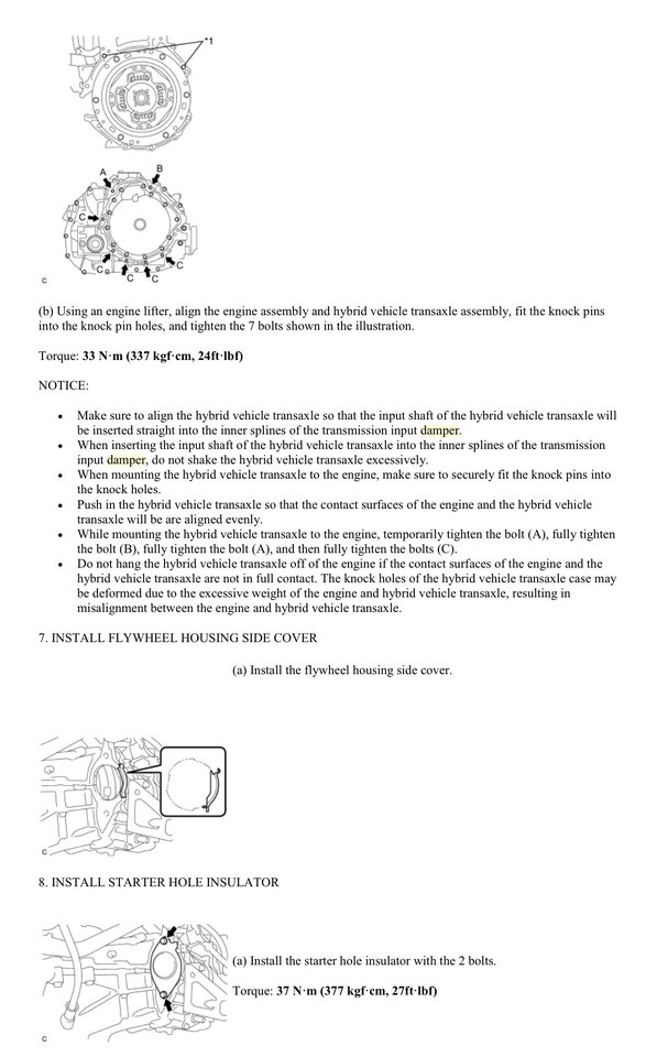

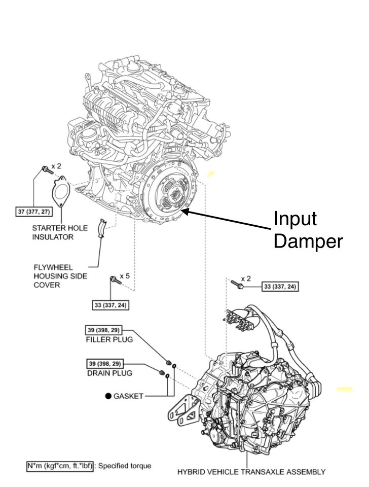

    The drive shaft between the engine and transaxle could be broken. There have been reports of this happening a couple of times in this forum.

    There is a spring loaded damper that slips and makes the awful rattling while misfiring. It could be broken and has happened before as Brian noted.
    If the above was allowed to happen many times as the hv battery drained, the damper springs could have failed. Rare but possible. Even more unusual would be something jamming the engine as a result.
