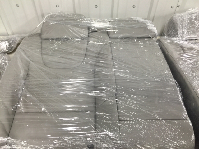

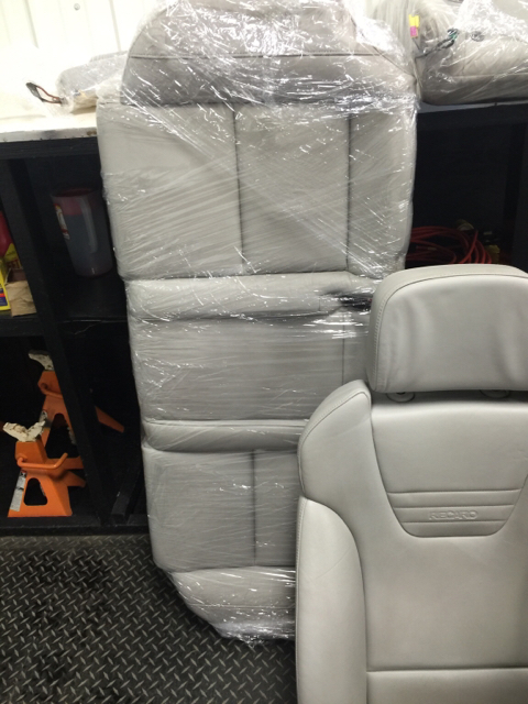

    Very interesting! I'm actually planning on doing this myself - I got my favorite seats already but I didn't spend too much time measuring so hopefully they fit - the Prius seats seem kind of not very wide.
    I'm currently on a business trip - so I won't have the chance to work on my project for at least another month!
    If you have any photos I would greatly appreciate if you could send them to christos_adam at yahoo!
    I'm also trying to see if I can transfer the skin and seat heaters to the rear bench.

    Waa them seats look really nice! I like them, I will try send them pictures to your email address.
    Just 1 advice start with the passenger front seat first, you also have a lot of wiring to do, you are correct prius seats are not that wide, measurements 40x40
    GOOD LUCK...
