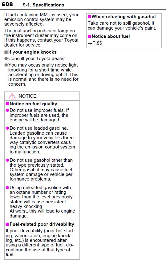

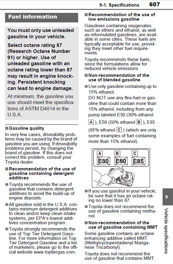

    Below is what your 2023 Prius Prime Owners Manual says about fuel. Notice that it says to not use methanol, MMT, leaded gasoline, E30, E50, E85, or anything containing more than 15% ethanol, but it does not say anything against E0 or requiring any ethanol at all.
    It notes that ethanol and reformulated gasolines "are available in some cities" and recommends them "for reduced vehicle emissions." This is an indirect acknowledgement that the allowed ethanol mixtures (e.g. E10 and E15) are not available everywhere, and are not required.
