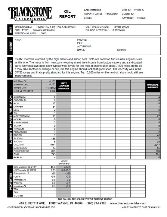

    Here's my factory fill for reference. It's almost a mirror image of Mr.Incredible's initial change, but mine had >8k on it.
