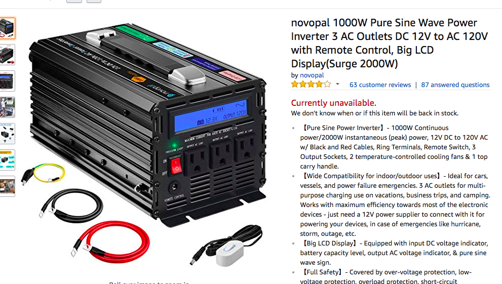

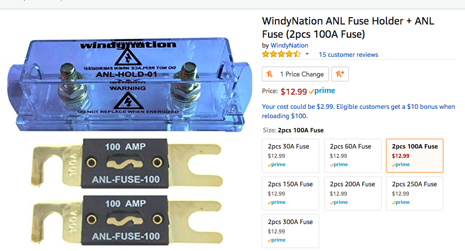

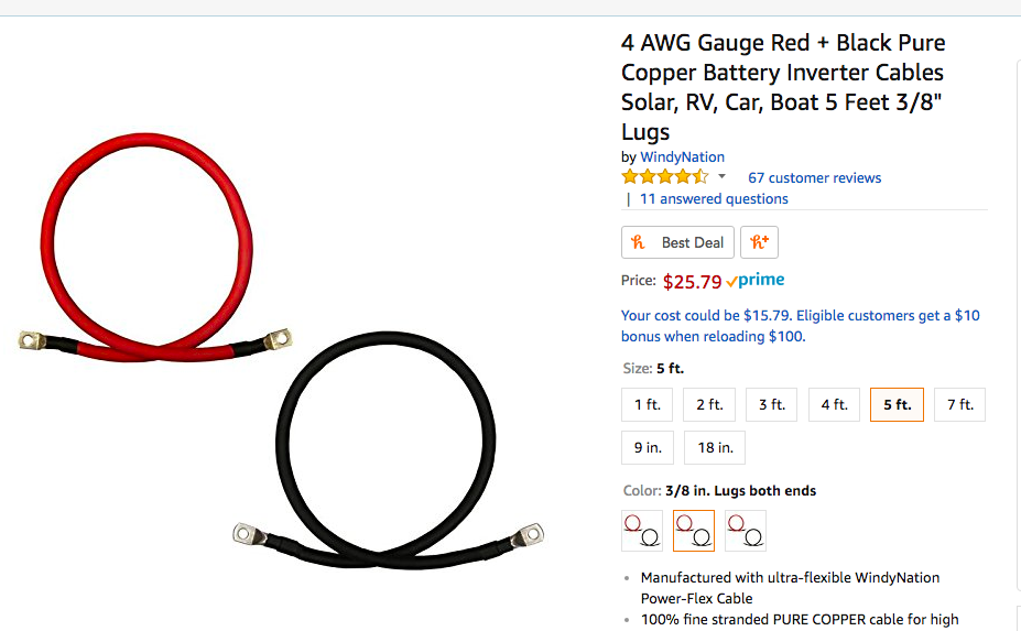

    Here are the items I got from Amazon--this list worked perfect for 2009 Prius.
    The installation itself should take less than half an hour. Total Cost: $195
    (BTW: I have an external high quality gas generator and my home is wired for it. The Prius inverter was done for 2 reasons: Camping comfort and for my Wife and Daughter's ease. They know how to place the Prius is 'Ready' mode and they are familiar with the use of an extension cord. I really don't want them to deal with the heavy external generator and flipping the switch at the junction box).
    Simba
    The 1000W sine wave inverter: $156
    Cables: $26
    Fuse holder: $13
    Alfred34 and cwerdna like this.
