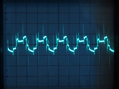

    In DC terms, it is floating. The isolation is tested by the battery ECU imposing a distinctive AC waveform and measuring how much of that can be seen with respect to body ground. That value can be seen in the Techstream data list as the amusingly-named "short wave" value: not a radio band where you can pick up distant broadcasts, but a roughly 5 kHz wave used for detecting shorts. :)
    Veteran member hobbit gave some details about the waveforms and related filtering and grounding issues.

  17. ChapmanF
    28,731
    19,027
    Weird-looking wave, should be somewhere on the bridge of a Klingon vessel.
