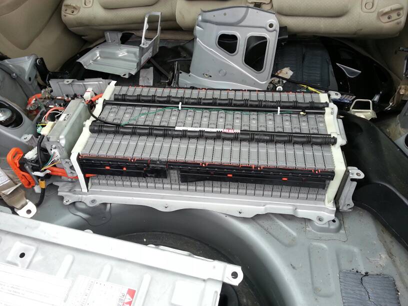

  6. fuzzy1
    17,922
    10,706
    I finally dug far enough into my battery & power assembly to see the same view as shown in the fifth (last) image on the ebay page, so that is a Gen3. What I found is not yet enough to scare me away, so this route (direct tap into the HV) is still an option. But more thinking is needed before I do anything.
    The pink conduit in the ebay image is the added wiring to take power to the added inverter, and it looks like a good route for a pigtail to a power socket of some sort. I have a bit of larger 1/2" plastic conduit that appears identical to the conduit carrying the main HV lines towards the HSD (not shown), but it is too large and inflexible to fit as shown, at least without some modification to the sheet metal that it passes under. I'll have to look for some smaller stock.
    This will still need some strain relief and chafing protection from that sheet metal. The black conduit next to the pink passes under at a point where the sheet metal is both cut back and bent 90 degrees, so it won't slice the conduit in a crash. But that feature may not be wide enough to protect an added second conduit.

    For those interested here's a pic from a Camry hybrid.
    Alan.. Sent with Tapatalk 2
    DadofHedgehog likes this.
  9. bwilson4web
    29,096
    16,533
    This is one case where an Anderson connector works. At high currents with a 12V installation, the (I**2)*R losses are pretty ugly. But at 200V, the lower current makes the Anderson a good solution.
    Now Richard's installation involves 'home' battery unit and inverter setup. So his Prius is in effect the recharger for the home batteries. Not a bad solution although we've not discussed 'in rush' risks. I would probably want a current limiting resistor on the initial connection that has a by-pass relay to allow a step-wise bypass of the current limiting resistor.
    I'm still more interested in a permanent installation as this means we don't have to deal with connecting power electronics under the stress of a power outage.
