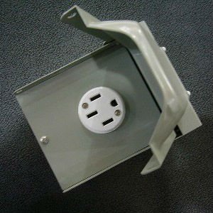

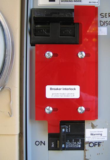

    Not quite true. These are legit, as they physcially prevent someone from backfeeding the utility line. They make all different ones for different panels.

    I was aware of those. They make one for my breaker box. I am not sure if i meets code. They also well locks for a single or dual breaker.

    I had an electrician recently to do a survey for sandy damage and I specifically asked about it. He said I can do interlock switch and use the house wiring and he can have a plug (some kind of special thing) installed outside and it is legal the main issue physical generator feed and main feed cannot be on at the same time. Then you can connect any generator. So this is not a hospital or datacenter live failover but for a home this is sufficient...
    Since I am doing full rewiring of the main floor this is not really any extra at all and a good idea to do at the same time.

    Electrician here-
    If you use one of these
    You won't have to make a "suicide cord" (a cord with 2 male ends) and used with a UL listed breaker interlock kit it does meet the requirements of NEC article 702. Local standards may vary slightly but I have installed systems like this before and had them inspected personally.
