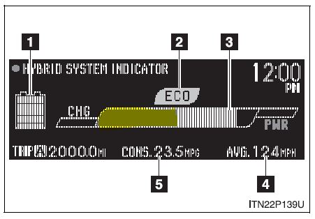

    As you've noticed, the car often shuts the engine down and runs electric-only. Even the Owners Manual has tip for triggering this, saying to lift off the gas and gently re-apply. At lower speeds you'll typically stay in electric-only as long as you keep the Hybrid System Indicator display to the left of median (yellow zone in pic). I would just be careful with it, use it while state of charge is high, but once it falls off to about half-full not so much.
