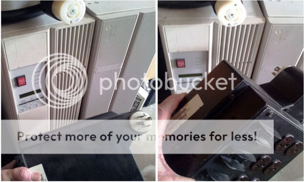

    So using one of these APC units with any Prius or PiP? in HV mode you should be able to charge a PiP with the Level 1 EVSE? Level 2 if the pilot signal PWM could be changed to match the amps out of the 208v models. Not sure the commercial Level 2 units are that adjustable but the Open EVSE should be. What's the minimum amps needed by the PiP for Level 2? Or the Max it will pull? (OK not efficient but it could be done right?)
    The APC 208v units have programmable ac outputs for 22ov, 230v, and 240v depending on the model. Anybody change theirs or check to see if the used ones had been changed?

    Some of the newer Prii do not have 201 volt nominal batteries - the battery spec can be found on Toyota's website with the other Prii specs. The ones that are higher would have to be measured to find out what their operating range is. My 2008 Gen II runs 200-244 volts depending on state of charge, and briefly drops to 190 when the engine starts. 244 is a bit above the normal operating range of the APC's DC bus, but it doesn't complain. Much above that and I would worry about destroying it.
    The APC SURTs are programmable to output any of the above AC voltages, I changed mine to 240 when I got it.

    Your older UPS natively outputs split phase 120/240, which was typical of the older UPSs. My 12-year old Liebert does the same. However, modern server rooms have gotten rid of 120 volt equipment and typically use 208 now. The more modern APC UPSs output unbalanced single-phase 208 (or 220, 240), which can't be converted to 120/240 split phase without a transformer. I use the APC SURT003 since I could get it as cheap as my UPS and it stacks on top nicely. There are two very (very) rare models that output 120/240 natively but all they did was bundle the SURT003 transformer within the UPS case. I've never seen one for sale on Ebay, far easier to get one of the common models and the transformer. That gives me 120/240 split-phase so I can hook it directly into a subpanel, which I installed right after I got my Liebert. That panel has almost all of my 120 volts circuits, the only exceptions are things like my attic and crawl space which just don't need power in a blackout. When I only had the batteries hooked up I did load management from inside the house but now with the Prius I don't worry about it. I don't use the Prius to charge the lead-acid batts, I disconnect them when the Prius is attached.
    When I bought my Liebert I immediately recycled its batteries and bought 16 deep cycle flooded lead-acid batteries. I specifically bought it because it could be fed directly from the Prius but I decided in the end to get the batteries. We get enough brownouts and short blackouts that having the UPS work as a UPS was nice. Later I finally got around to tapping the Prius and using it to feed the Liebert after a hurricane took out the power at my parent's house for 3 days and I realized I could have kept their lights on with the Prius and Liebert. Soon after I decided to look for a more modern replacement for the Liebert, it is getting old enough that I was worried it would die soon (ironically the charger in my APC died the day after Christmas). That led me to the specific models of the APC SURT line. I ran two 12+ hour tests to see fuel consumption and see it in action, finally when Sandy came I used it for real.
