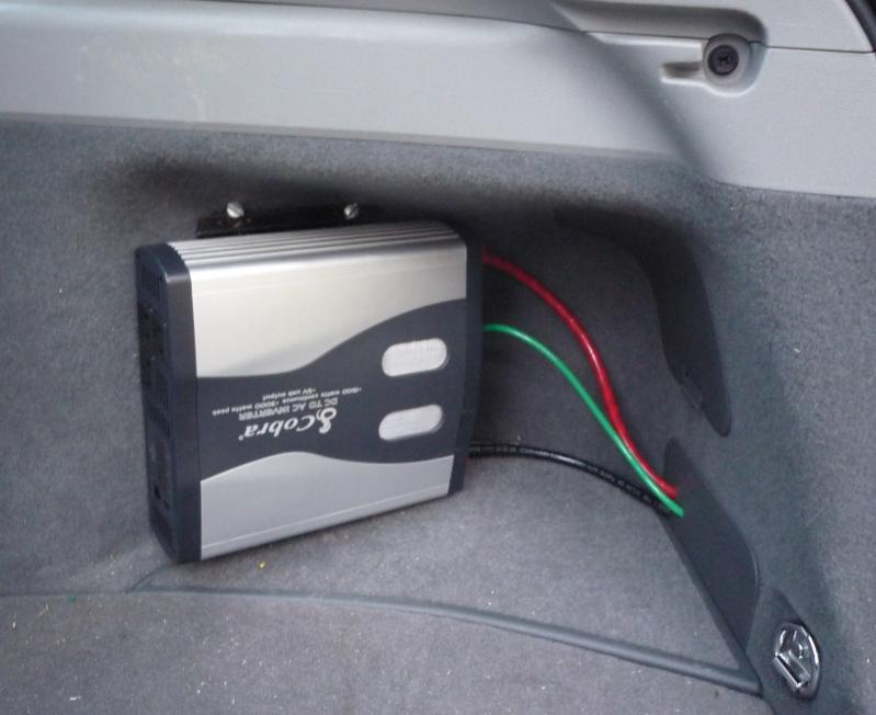

    Here is my setup:
    Scarface2005, lensovet and wjtracy like this.

  19. it's amazing what people don't know about the car.
  20. so, I assume that the red/green are + and - to 12V AND the black ?
