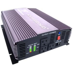

    This is the one I used.

    "12 V of current"

    interesting, so the 1500W model doesn't have the connecting cables. wonder why.

  11. El Dobro
    El Dobro A Member
    Jul 12, 2011
    7,106
    3,282
    Mine came with them, but they're not very long. I didn't want to keep the inverter in the car.
