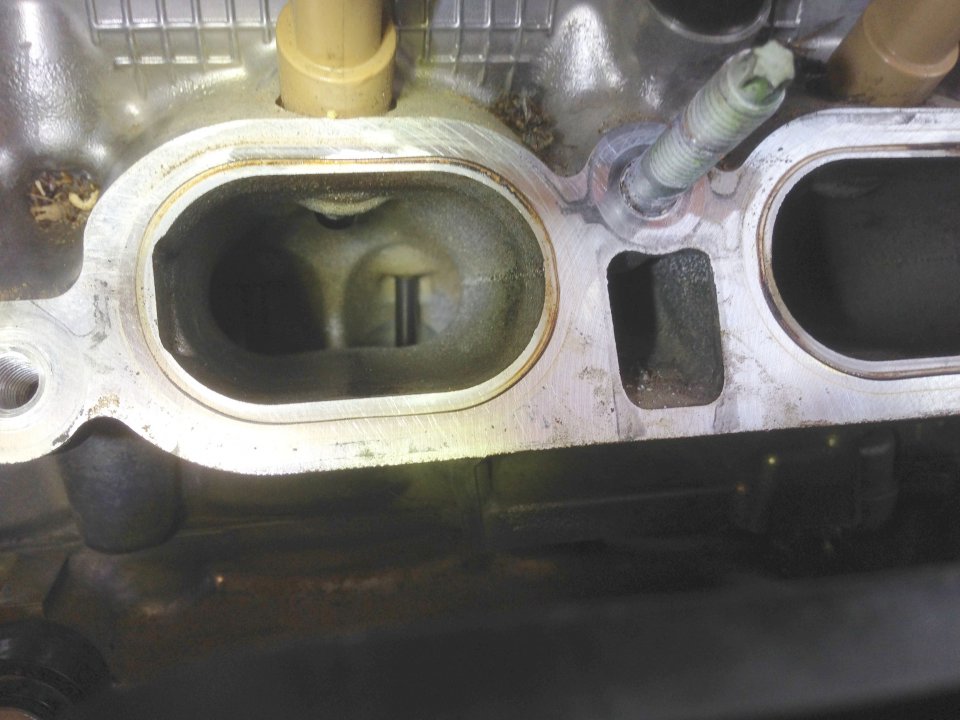

    Yesterday I took the inlet manifold off to check EGR carbon build up. I've driven 182,o7o Kms and saw in another thread that blockage from EGR carbon can cause misfire. From what I saw in my manifold and the s/steel tube running to it this should be a regular service item at 60,000km intervals.
    What fascinated me however, was the cleanliness of the intake area of the head. I have used Premium 98 octane (RON) fuels in this vehicle since day 1. I've attached a picture to demonstate.
    I know with other vehicles this area can become quite gunky, especially as it is obviously pulling minute amounts of oil from the crankcase.

    I don't believe the octane makes any difference with how clean it leaves your car. 87 octane from top tier gas stations with their detergents would be the same cleanliness, at least in the USA.
    I do notice you are down under, so fuel may be different there.

    Yeah I agree about the octane but the 91 and 95 don't have the same level of cleaners here.

    Intake should be clean, that is airflow. Fuel injection occurs in the combustion chamber. If you are really looking for carbon buildup, then either bore scope the combustion chamber or pull the head.

    The prius EGR is a lot more complex than the average EGR valve. Has electronics and water cooling. Never the less I took mine off and cleaned it. Hope there isn't something I don't know about. It's possible Grumpy's electronics packed up.
    My Prius has 113,000 KMs. But has been mostly travelling high speed freeways or dirt back roads. Grumpy's was used as Taxi. Stop go all the time.
    Please look at my photo. The injector nozzles are clearly visible at the top. Prius is not direct injection. My 1953 TEF Fergie tractor is direct injection. The Poms had great ideas and engineering back then.;)
    The Australian Manual suggests any fuel fom E10 up is suitable but reccomends 95 or higher.
    P.S. Grumpy, the premium seems to have kept the head inlet and valve stems clean but still blocked the EGR. Don't beat yourself up!
