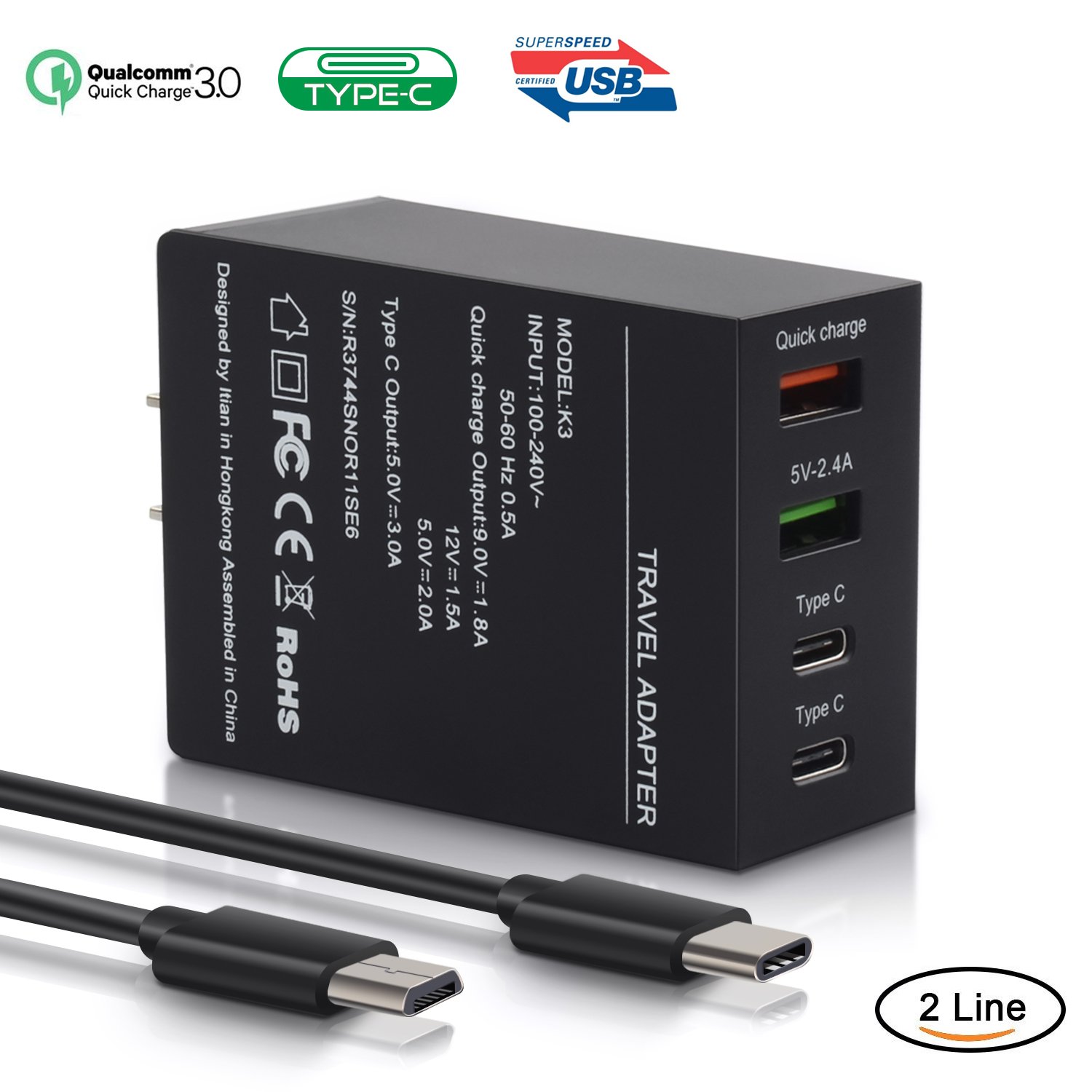

    You won't believe what I went through to finally get the proper batteries and charging apparatus. Ordered one battery, found out it didn't have the type c input, returned it, found the correct battery, ordered it, I have a meter that fit's in the usb outlet of the charging adapter so I tried the charging adapter with a regular USB connector on one end and a USB type C connector on the other end, tested it out and the amperage was only 1 amp at 5 volts. Removed cable and tried USB to micro USB and got 2 amps at 5 volts, better but not enough, USB type C is supposed to be 3 amps at 5 volts. Turns out you need an adapter that has a USB type C output on it and the cable needs to be USB type C on both ends. Sadly RavPower does not sell Type C charging adapters even though they sell batteries with a Type C input, ended up sending their "super fast" charging adapter back and having to pay return shipping. her's what I got instead, comes tomorrow
