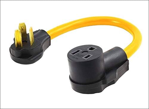

    Wouldn't this $19.99 (on Amazon) adapter cord work? tinyurl.com/v3y4zwkn (this one is a 10-30)

    Nope. It's a 10-30 to 6-50 adapter. You can't plug the 5-15 plug on your EVSE into the 6-50 part of the adapter. Note that the wide and narrow prongs are opposite between the 50A 240V (6-50) and the 15A 125V (5-15) plugs.
