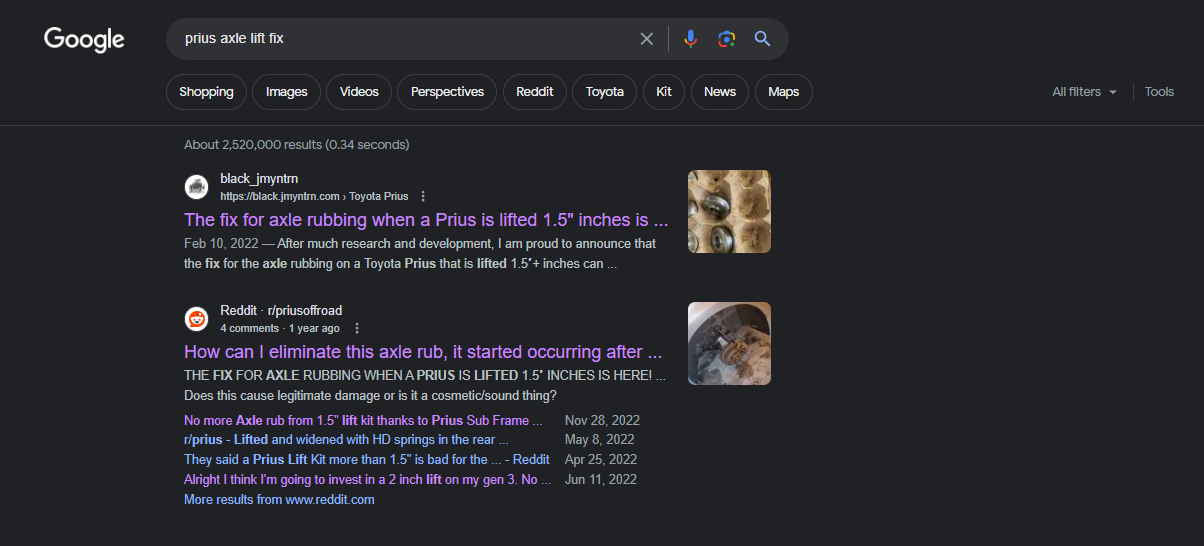

    way off topic, so respond only if you want to.
    Did you find a fix of the 1.5 lift - cv(?)-axle issue.
    I couldn't find it, easily...
  14. black_jmyntrn
    black_jmyntrn Senior Member
    Oct 23, 2020
    1,728
    407
    2013 Prius Plug-in
    ohh yeah! I created it so I could lift as tall as I am now.
