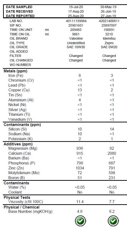

    Finished a 9800 mile run with the oil, no consumption. Will send in for an oil analysis.

    - Oil was in use for 8 months under a mix of city and highway driving.
    - Head gasket was replaced at 185K miles due to failure. The valve stem seals were also replaced at this time.
    - No oil was consumed during the 9,861 miles. The oil level remained at full. This engine has never burned oil.
    - Fram Ultra oil filter was used.
    Also posted on bobistheoilguy.
    Raytheeagle, ASRDogman and Grit like this.
