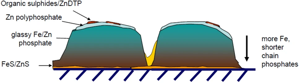

    Lake is one of the Oil Geek I am fan of. He does not push any marketing, just educative with science and number. All quantified.
    No one can replaced wear metal parts with anything. The main concept on RP Valvoline is removing varnish and gunk. Additives like ZDDP and MoDTC are bonded to the metals, actually eat the metal a bit and create a hard glassy solid surface, this layer reduce the overal wear because it is replacable and as hard as steel. https://link.springer.com/article/10.1007/s11249-025-01968-3
