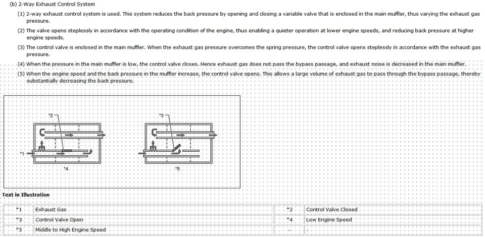

    Here's the meat and potatoes...

    Is this from a Prius manual?
  18. RRxing
    RRxing Senior Member
    Jul 7, 2009
    2,563
    1,842
    NEPA
    2010 Prius New Car Features. I downloaded it along with a host of other things from the Toyota Technical Information System (TIS.) Was $15 for two days access back in 2009. Here's the link...
    https://techinfo.toyota.com/
  19. El Dobro
    El Dobro A Member
    Jul 12, 2011
    7,106
    3,282
    Ok. I'm trying to figure out exactly where the valve is. Your attachment says it's in the main muffler, so where is the main muffler? The parts book calls it the piece at the end of the car, so if that's it, it's not what the OP is looking at.
  20. bwilson4web
    29,099
    16,535
    Perhaps this helps:
    Source: 2010-Prius-NCF-Engine-Exhaust-Details.pdf
