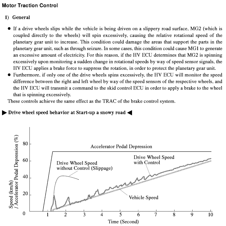

    Does anyone remember this chart and discussion?
    It's going to take a whole lot of hard in-my-face evidence for me to
    ever believe that anyone's car isn't at least TRYING, no matter how
    delicately, to rotate the wheels. I do observe that it tries a bit
    differently based on accelerator position, but never a complete
    refusal to try at all because there's no way for the car to "know"
    about the surface under it beforehand.
    _H*
