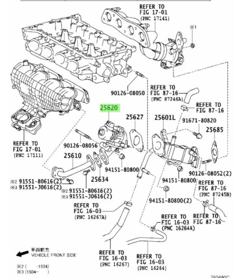

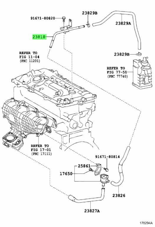

    Ignore the green highlights in this topic. Just for reference.
