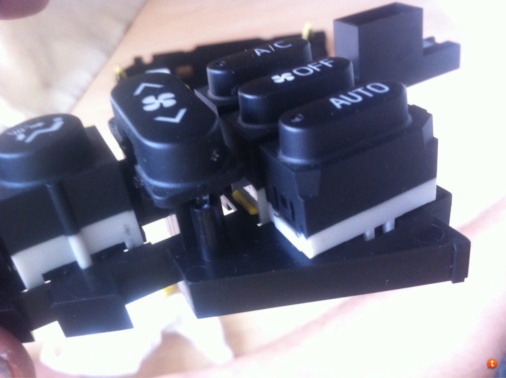

  12. kevtan
    kevtan Member
    Aug 31, 2013
    30
    Problem solved it the design ,after adding the yellow padding now no more sticky button defect[​IMG]
    minkus likes this.
  13. mdgates
    mdgates Junior Member
    Dec 2, 2012
    67
    23
    Buffalo, NY
    Kevtan, did you see what they're using to make the buttons spring back out? And is that yellow pad a thin sheet of silicone, or what?
  14. kevtan
    kevtan Member
    Aug 31, 2013
    30
    It use the tiny onboard switch to bound back the buttons which not have enough power to bounced it back , the yellow pad is just some foam padding from some toy battery compartment ,
