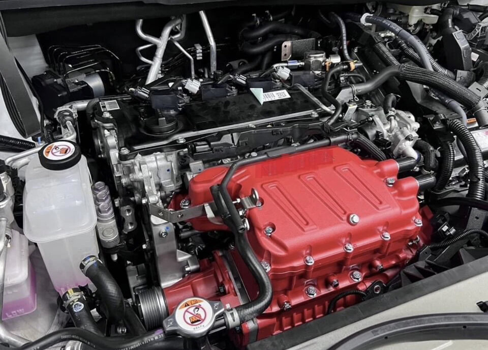

    Saw someone talking about this guy on the subreddit. Anyone think we could get this working on our M20A-FXS? I shot their support dept an email asking about it but I haven’t heard back yet.
    (pics from the product page)

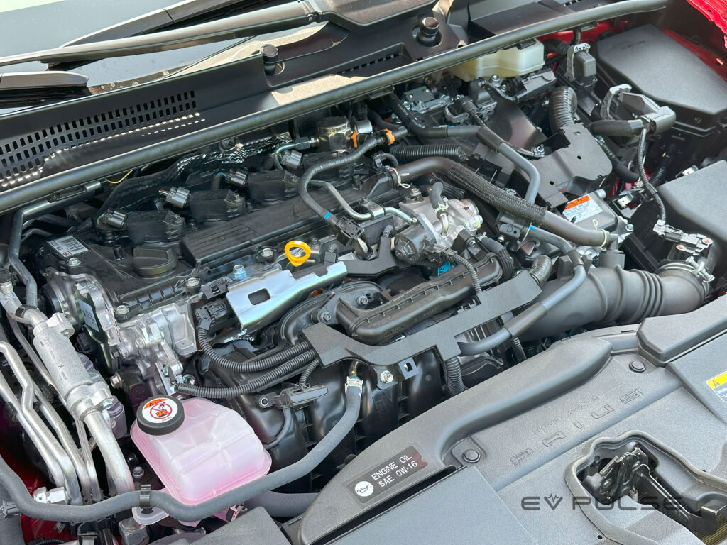

    Is that even a 5th gen engine bay, I'm seeing precious little familiar:
    With:
    ^ Stock 5th gen image cadged from here.
    Just curious: what is the object of this?

    It absolutely is not, in fact that photo may be an A25A, the 2.5L I4 engine in a Camry. This kit supposedly fits vehicles with both the M20A and A25A, which makes sense because the only difference between them is the size of the cylinders.
    As for what the object of this is: supercharged prius is funny and I want to. I don’t think that there’s a single good reason to do it, so I won’t pretend there is.
