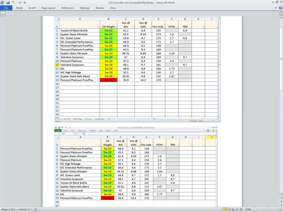

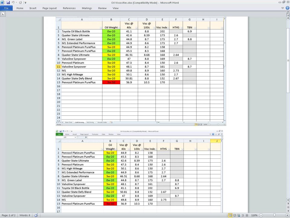

    He outlined his research, how viscosities overlap with different weighted oils, etc., but I honestly don't see the point he's making. You can be good at presenting data, but if you can't make any determinations, or come to a conclusion that differs from what is documented should be done per the manufacturer, what's the point other than what I said above? He can do all the testing of different viscosities and experiment with his own car and report back, but other than that, he apparently is not changing any minds here.

    This is a useful compilation that shows the variations within a specified grade. If one wants to investigate the differences among oil performance specifications, see the link below. Especially note the considerable performance differences between Toyota's specified "ILSAC multigrade" and the A5/B5 and A1/B1 ACEA grades.

    I thank those that had relevant comments and participated in the manner the thread was intended to take. I hope there were at least a few people that found the spreadsheet thought provoking and interesting.
    I apologize to those who felt I insulted them. There is a lot of nuance lost through the keyboard when inflection and eye contact is not experienced. But there are those who seem to enjoy the fight since they have nothing else to bring to the table.
    The info about the viscosities is easily found online by googling the brand name, the oil weight, and Technical Data Sheet. " Pennzoil Pure Plus 5w-20 Technical data sheet " . It is sometimes enlightening to find things out for yourself.
