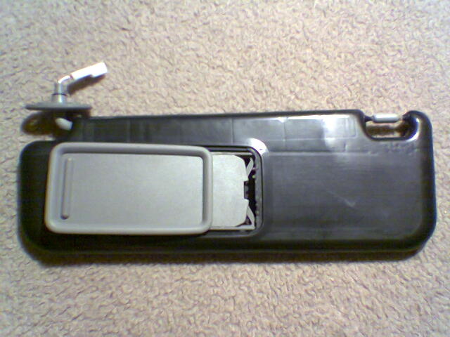

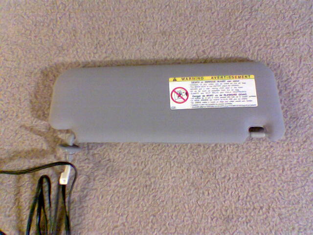

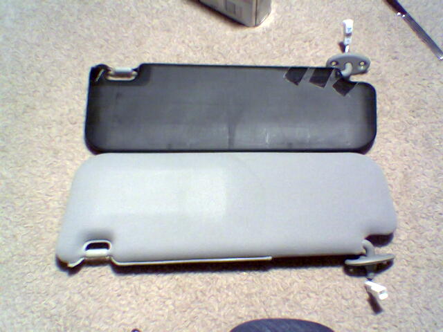

    It's a cake walk! Two screws and one plug. Takes about 35 seconds to take the visor off. The passenger visor looks really funny on the drivers side - for those of us that have destroyed our drivers side visors :lol: :lol: :lol: B)
    The visor mirror is a simple switch; it completes the circuit allow the switched light to turn on. The pins in the connector seem to be the same pitch as all of the other wiring harnesses - i.e. you could use them for the EV mod.

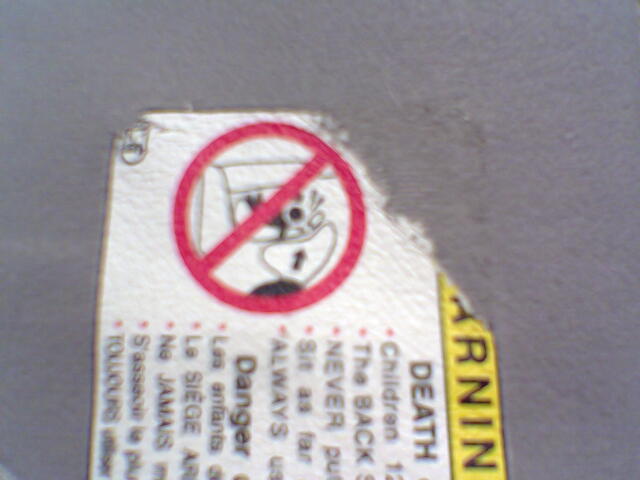

    So, here are the pictures. Apologies for the low quality - other camera is MIA.
    Starting with a removed visor:
    After an hour of fussing with the iron and a wet rag and then the steam wand from my Espresso machine:
    Don't pull too hard:

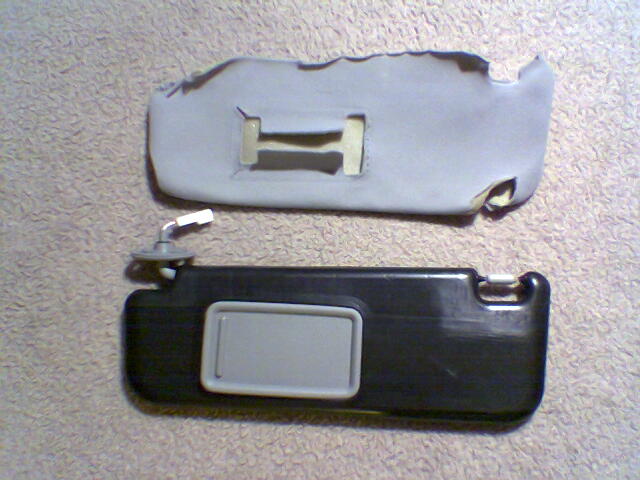

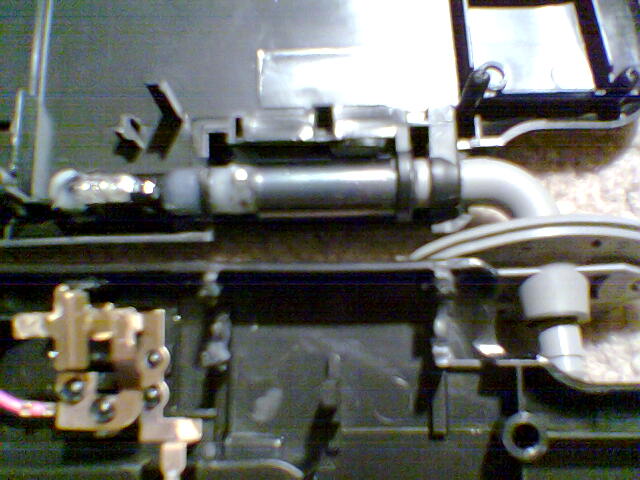

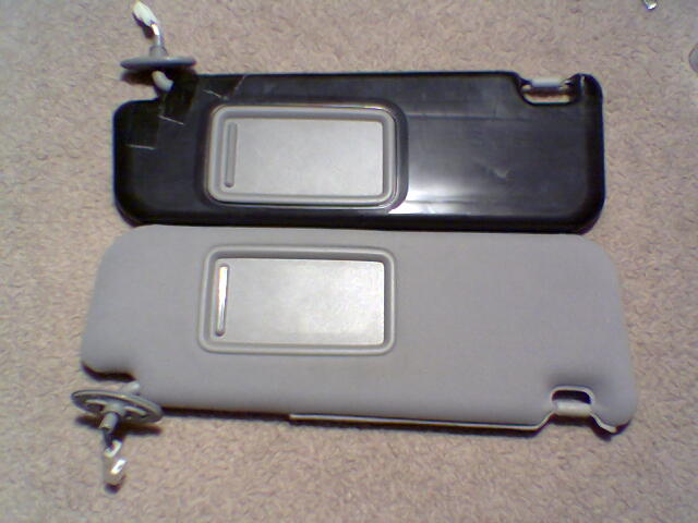

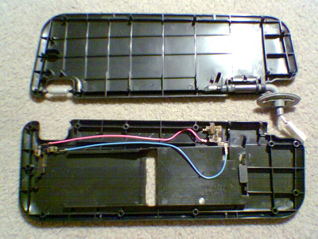

    Since I've basically destroyed the visor, let's see how it was constructed:

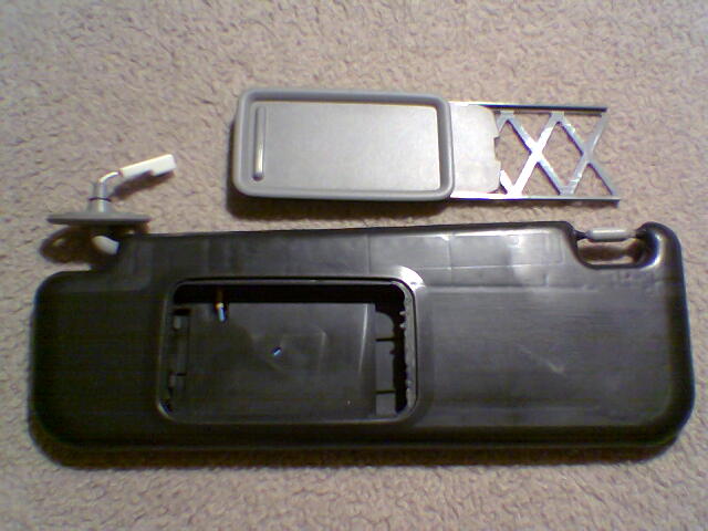

    The mirror pops out. The glass cover has to be slid open and then there are two clips on the left of this picture. The mirror and the slide assembly remove as one after it's been removed from the clips and pulled up a bit.
    Don't try to take the plastic housing apart. The hinge is pressed in place and removing it requires breaking two plastic clips:

    No, I did not 'soak' the fabric. I heavily moistened 20mm around the edge of the sticker and on the sticker. I used a wet rag and steam. Then when that didn't work well, I used the steam wand from my espresso machine. The steam wand worked ok, but I think that it was too hot and caused the glue to set in deeper into the fabric.
    After taking the visor apart, I understand why the visor needs to be heavily soaked - water needs to be _under_ the sticker. When the iron is heating, the water under the sticker steams the glue from the under side. Since I was unable to do it, doesn't mean that others (with more patients and cooler irons) can't do it! :)

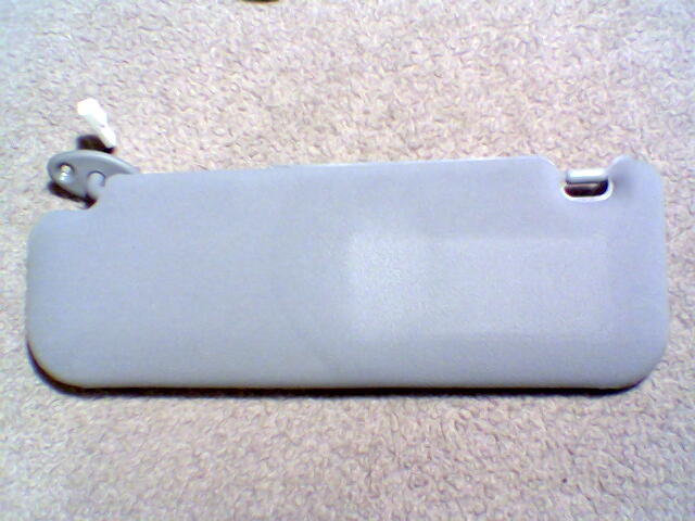

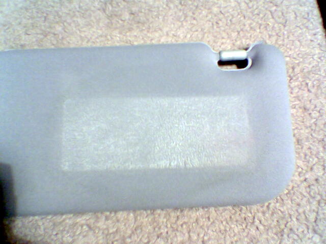

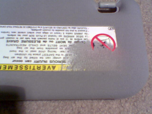

    Well, I can absolutely verify that heat will do nothing to loosen the glue. After some research and two different sets of trial and error, it is my opinion that heat does nothing to remove the label.
    I investigated other forums (BMW, Mustand, GTO, etc...) most folks say that heat does nothing and risks warping or melting certain plastics.
    What I found is that the labels on the Prius are vinyl. The fabric and plastic are made of something else. Vinyl is dissolvable with Acetone.
    I ended up using Acetone to wipe/melt the sticker away. The only other plastic items on the visor that reacted to acetone was the latch clip cylinder.
    It's starting to dissolve...
    And gone!
    With more wipes and some brushing...
    Here's the pair together:
    I'm sure with time and some more scrubbing, the area with the glue residue will subside.

    Yeah, but unless the judges are really keeping their eyes peeled, they will see the the obnoxious yellow header and think that it's the standard air bag warning. However, I do think the star chart was an excellent idea.
    I scrubbed the visor some more and it's pretty damn hard to tell where the sticker was. You can faintly see the rectangle where the sticker was pressed into place. Plus, Acetone is a great test to see how safe you are - because the you get the change to risk: sterility, going blind, nervous system break down, and a high like no other.
    If you plan to use Acetone, please use a ventilation system (if you have a vent hood to work under ++), eye protection (preferably goggles), and gloves.
