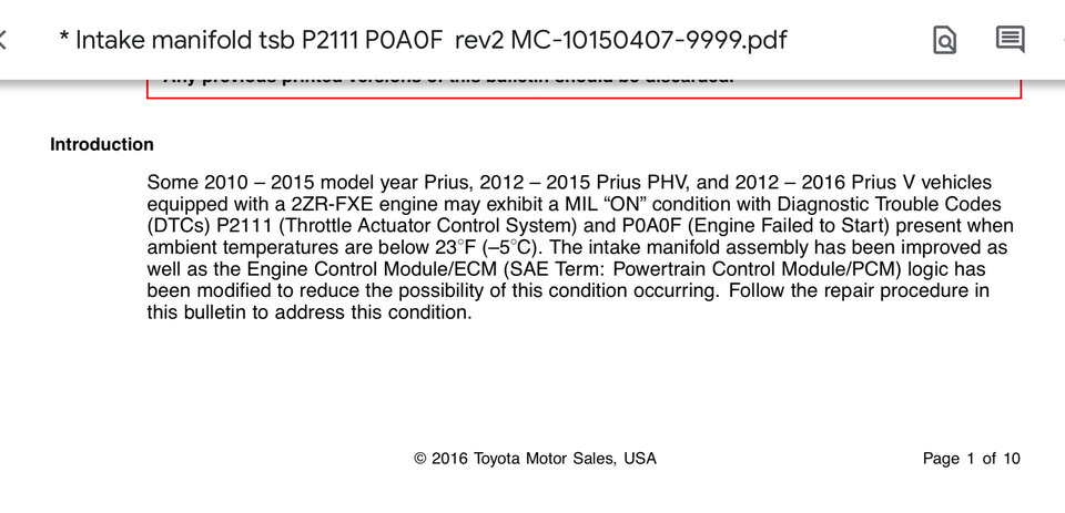

    Somehow I keep forgetting that more than one TSB announced revisions to the gen 3 intake manifold.
    T-SB-0010-12 was the one about snorting condensed water from the EGR passages. That's the one I usually remember. It said to update to a -52 manifold in the first revision, then later to -54.
    T-SB-0103-12 was about the throttle body sticking open. Looks like I knew about that four years ago but I usually don't remember it. It says to update to a -91 manifold.
    I don't think I had ever even stumbled on T-SB-0116-15, which is also about replacing the manifold, this time for misfiring when driving with EGR active (the usual effect you'd get if the passages were gunky, fixable by cleaning them). That one also pushed the -54 manifold (rather than taking the time to clean the existing one).
    The most interesting one I forget to think about is T-SB-0103-12. The symptom is a P2111 code, which is when the ECM tells the throttle to close and that doesn't happen, and apparently that was (not) happening below 23 ℉ (−5 ℃), and they somehow meant the -91 manifold to improve that. Hard for me to guess why, but that might be the one that comes closest to giving a reason for the weird griddy gasket under the throttle body.
    Edit: typoed the number of a TSB

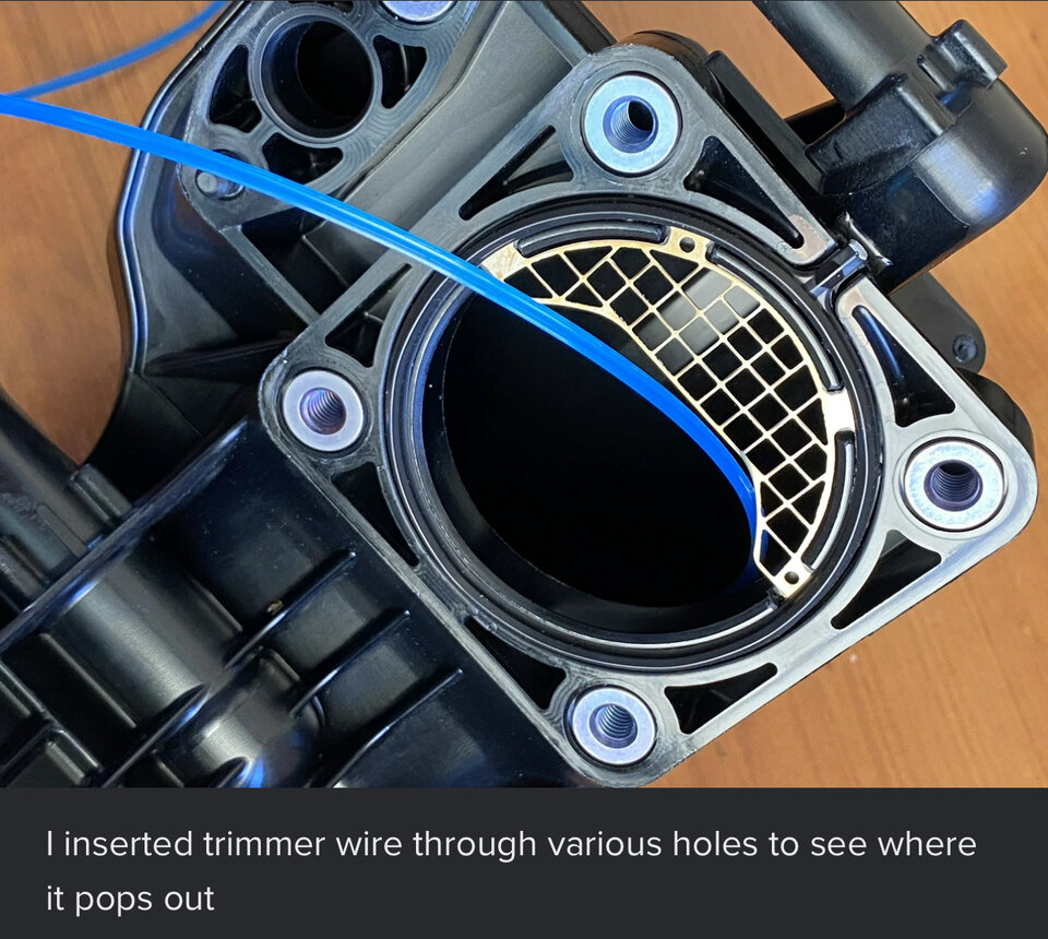

    Two of the differences so far mentioned are: (1) a difference in routing of the small EGR gas passages, and (2) cut to accommodate, under the throttle body, a different gasket with a weird grid insert.
    I think I kind of know what the EGR passage changes were meant to do. The griddy throttle-body gasket baffles me, but it is something that started appearing in more cars around a certain time.

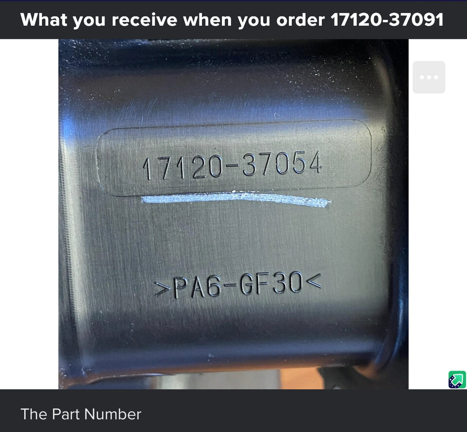

    I finally bit the bullet and ordered a new intake manifold (17120-37091) and will report back on whether they actually send me x91 or x54.

    You'll be reporting back on whether the one they send you has x91 or x54 as the number visible on it—which, because numbers visible on Toyota parts are not always their official part numbers, is a subtly different question.

    Pretty sure you will let us know that the manifold has 54 stamped on it and the box has 91 on it.
    The manifold will come with the designed gaskets.
    Would be awesome if there is an actual new molded manifold but I doubt toyota did that.

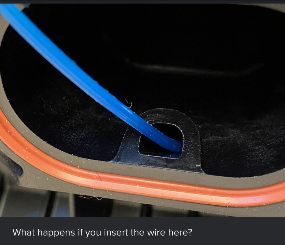

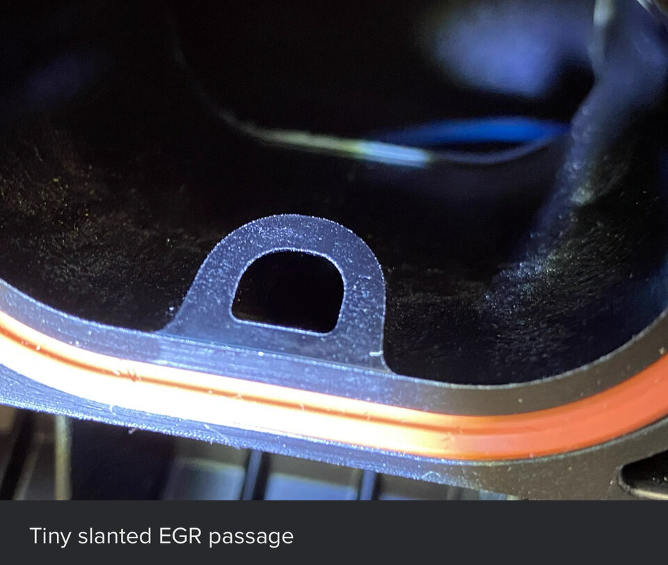

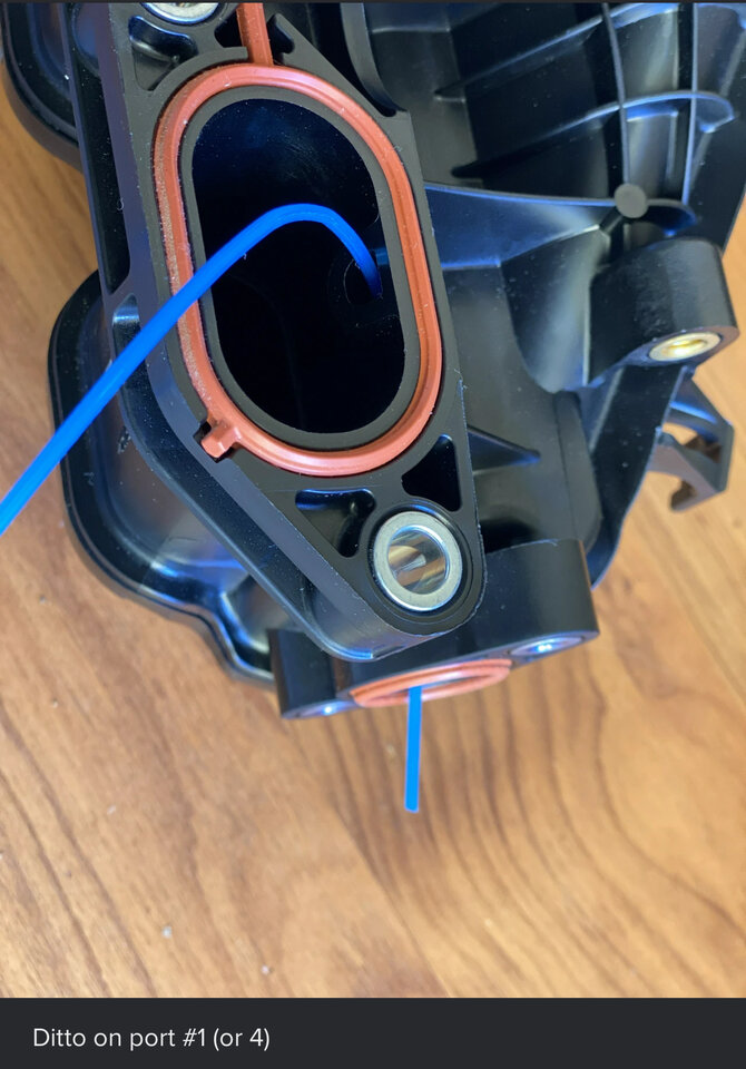

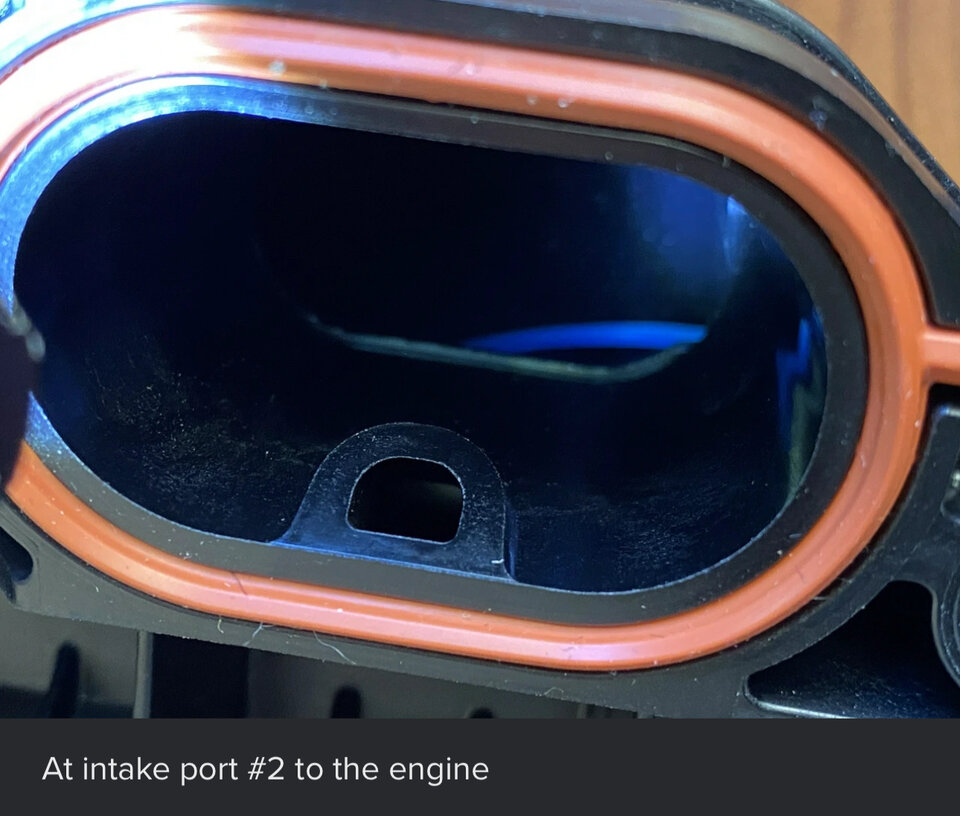

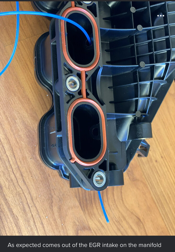

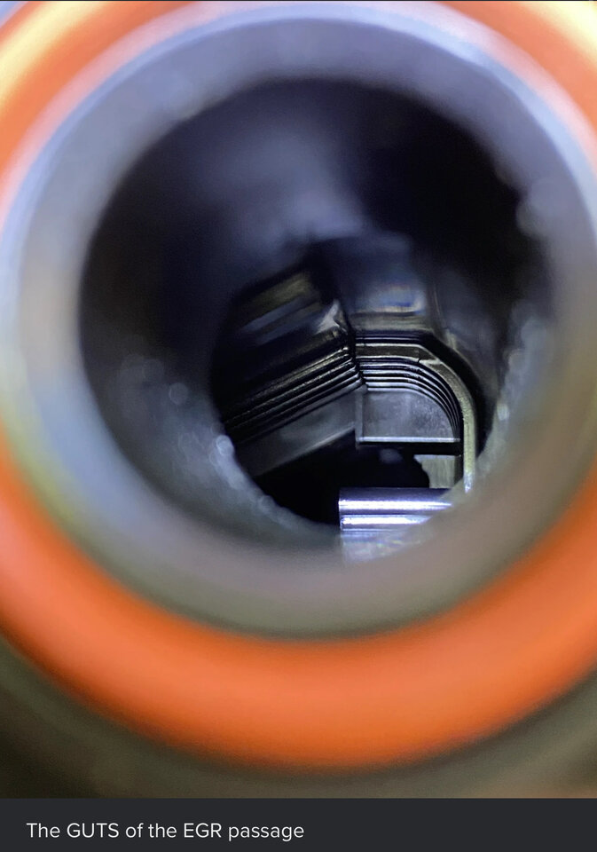

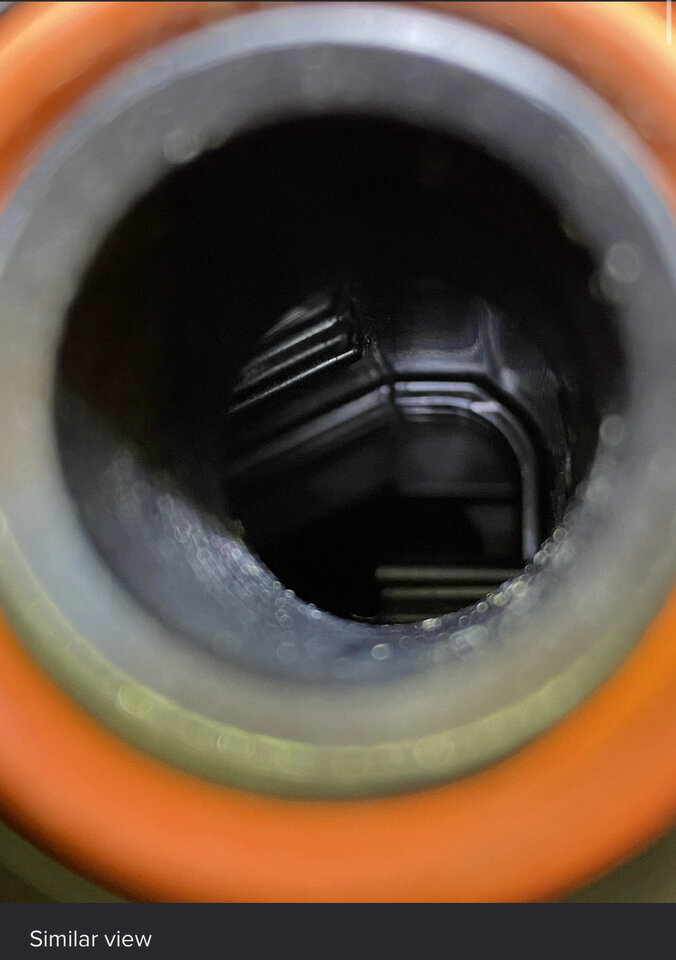

    So I finally received the intake manifold (17120-37091). It is, as expected a 17120-37054. Let the pictures speak for themselves:
  16. ChapmanF
    28,740
    19,038
    Or, at least, it is a manifold with the number 17120-37054 visible on it.
    For whatever reason, I see no pictures, but there is extra blank space in the post.

  20. indel
    indel Member
    Apr 1, 2024
    283
    89
    Northwest Indiana
    It might depend upon what device you are using to view the forums. The pictures are posted on imgur which I find to be a much better platform than posting them directly on priuschat.
