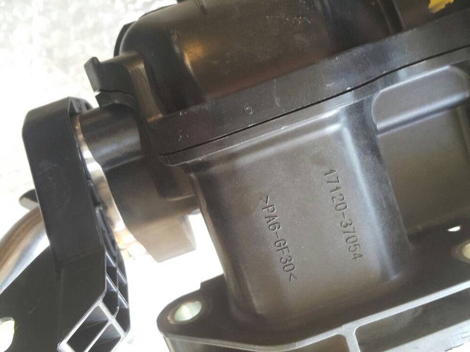

  15. AzusaPrius
    AzusaPrius Senior Member
    May 27, 2020
    2,257
    942
    Yup like I just got delivered.
    Picked it up from Ebay, you have to make sure they have a picture of the part number or if not then ask them to take one.
    I got mine with the egr tube attached.
    $100 + tax and $20 shipped.
