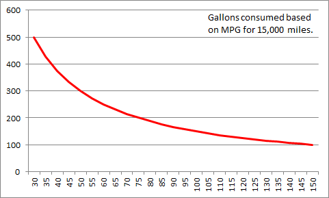

    There's no point of advertising anything over 100 MPG.
    It only servers to confuse & mislead, since the return beyond that point drops off significantly:
    That real problem is not informing people of actual KWH and GALLONS consumed.... which some Volt owners absolutely refuse to do, focusing on EV miles instead... which does not represent a true measure of fuel-economy, nor does MPG.

    There is no proper context. We all know the variance within EPA testing results and real-world vary dramatically. Beyond 100 MPG, that variance can be greater than the value itself.
    A consumer choosing a 300 MPG vehicle over one listed at 230 MPG may not use any less gas, based on how the vehicle is actually used. And even if they did get exactly what the sticker states for testing results, that's only a difference of 15 gallons over the course of 15,000 miles. That's just 450 miles of travel for a 30 MPG vehicle. That same "70 MPG" difference equates to 350 gallons of gas when comparing that same 30 MPG vehicle to one which delivers 100 MPG instead. That's 10,500 miles of travel for the 30 MPG vehicle.
    Context is far from clear and will basically never be represented properly in terms of MPG. The only appropriate method is stating KWH and GALLONS. For example:
    300 MPG for 15,000 miles = 50 gallons
    230 MPG for 15,000 miles = 65 gallons
    100 MPG for 15,000 miles = 150 gallons
    75 MPG for 15,000 miles = 200 gallons
    30 MPG for 15,000 miles = 500 gallons
    Notice how higher MPG doesn't actually make much of a difference? Notice how that MPG is achieved is not told?
    Then, there's the reality of how far a person travels before recharging. That makes comparisons even between like vehicles unrealistic. Between different vehicles, it's even more difficult. Since it takes a lot more battery usage to compensate for a less efficient engine, that mismatch complicates matters tremendously. It's a mess!
    How could vehicles appropriately depict efficiency without having kWh quantity information?
