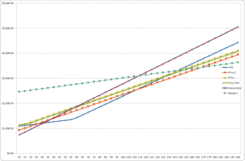

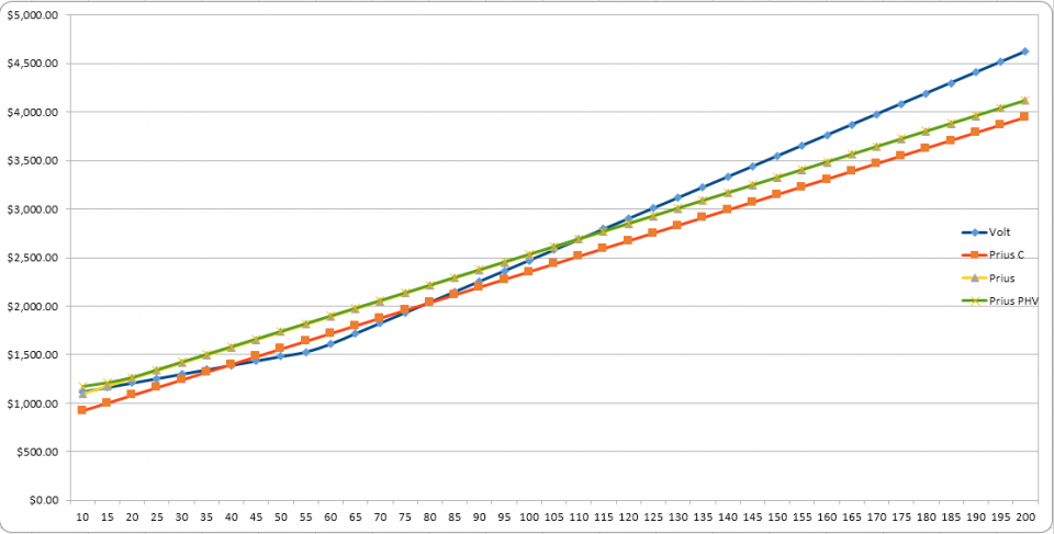

    Did a quick calculation of the ownership cost between the 4 cars. Ownership costs include gas cost, electricity cost and opportunity cost of the purchase price.
    Of course, these cars are in different segments, with different equipments. So this is for somebody who would only needs 2012 Prius C (2).
    Made the following assumptions
    1. All needs satisfied by Prius C (2). Ignore equipment/segment differences.
    2. Ontario price/rebate/taxes, all base model (2012 model for Prius C).
    3. Interest rate of 3%. (This is the opportunity cost of the purchase price)
    4. $0.1/kwh
    5. $1.3/liter
    6. No charging at work.
    Prius and Prius PHV are more or less the same. Volt has a sweet spot from 40km to 100km daily commute. Above that, it's poor HV mpg starts to show.
    If, however, the car can be fully charged at work, the Volt would almost be unbeatable for up to 200km/day.

    What's the x-axis?

    Daily commute in km.

    Good stuff. Your indicating a Versa Note and a model S. Which vehicle types are you referring too? Are there no startup costs when installing chargers at the home for the plug in models?
