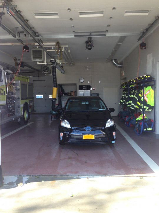

    I'm a vollie in NY and they allow us to have 1 forward facing blue light. I have a Whelen Dual Avenger mounted in the front windshield as you see; it's perfect behind the rearview mirror so it doesn't interfere with visibility whatsoever. I ran the chord underneath the lip on the edge of the A-pillar right down to the outlet, so it's a clean, simple setup that I'm pretty content with. I also have a less expensive lightbar that I mounted in the lower rear window that I don't use all that often.
