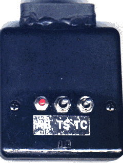

    If counting the right number of pins for where to poke the paper clip makes you anxious, you can make the one-step-more-civilized tool using a J1962 connector and a couple switches:
    but you can always read your current codes using the Acco tool, and make something nicer later. Again, there are ECUs in the car that won't blink you codes this way, so you will eventually want a real scan tool if you'll be keeping and working on the car. But this will work on the brake/skid ECU, and a #1 Acco takes up very little space in the glove box for use whenever you need it.
