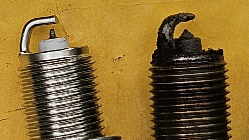

  10. dipstick22
    dipstick22 Junior Member
    Apr 7, 2016
    17
    Delaware
    I'm back with an update on my 300,000 mile 2008 Prius. I changed the spark plugs. Pictures attached. Quite a difference! Immediate difference resulting in a smooth-running engine. Reset the MPG but not seeing any difference (yet). I have not been driving it very far or very fast so it's possible that I'm not seeing the real impact on net MPG. With the smooth-running, I have had no VSC indicators, so my conclusion is that the rough-running engine was triggering the VSC flashes. Today, it coded P0420 - O2 sensor on Bank 1. I'm not surprised by that.
    With all this, I would greatly appreciate any confirmation and/or commentary before I close out this thread. I think the biggest learning for me was that engine misfires can trigger VSC indicators. I did not pick that up in my forum searches.

  12. dolj
    dolj Senior Member
    May 14, 2012
    8,652
    4,403
    Wellington, New Zealand
    Those plugs were well overdue for replacement. Just eyeballing from the photo, the gap looks to be twice (or more) the gap the new plug has.
    I would hold off doing anything on the P0420 for now. Keep clearing the P0420 until you have a couple of hundred miles with the new plugs. If you still get the P0420 after that, then look more into it.
    BTW, P0420 does not mean O2 sensor on bank 1. It means the catalyst system's efficiency (bank 1) is below the threshold. Give the system a chance to get back up to par now that the engine is running better with the new spark plugs.
  13. dipstick22
    Apr 7, 2016
    17
    Delaware
    DOLJ - Thanks for the advice on the P0420. I'll watch it for the next month. After the first 100 miles, the mpg is up to 50.2 which is a good sign.
  14. dipstick22
    Apr 7, 2016
    17
    Delaware
    Final update on this topic. I've now driven about 400 miles since replacing the plugs. I've had no more P0420 codes and my mpg is up the 50.5.
