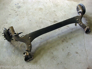

    Priuses are fairly unsophisticated in the back end because a trailing arm beam axle in the rear is as simple as is gets for a vehicle that doesn't have TONKA stamped on it.
    Still....there's other stuff back there that can be worn and set up an oscillation that would grow more pronounced at speed.
    TIRES....coil springs, shocks, hubs, etc...

    I think that I am seeing the floor through the sway-bar bolt holes in the photo above. So it would be fair to say that Prius rear axle doesn't have a sway bar, as of the moment the photo was taken. :)
    Just because people sometimes like to replace the factory one with a beefier one, doesn't mean there isn't one from the factory....

    The pictured twist beam also has drum brakes, which means it isn't a Gen 3 assembly. I think it was posted just as an example.
    And, the Gen 3 did not have a separate anti-roll bar from the factory. "Separate" because twist beam axles behave like giant anti-roll bars by design; the TRD and Cusco bars increase the roll stiffness by adding an external bar.

    I did post a G2 rear assy by mistake....not sure if there are many things that are different in the G3 other than the brakes.
    I'm still thinking that the sway bar isn't needed on the interstate because any place that you are able to clamp along at 100mph+.....is going to be relatively flat and straight........hardly uncommon in the southernmost Yankee state in the USA.

    You know, you caught me there. I remembered the sway bar in Gen 1 and 2, and I hadn't looked closely enough at my Gen 3 to notice it differed in that respect (even though I've been driving it for 4 years).
    Seems like the Gen 1 and 2 'beam' parts were a simpler C-shaped channel (facing aft) with the extra sway bar inside, but the Gen 3 part just has a larger and beefier shape for the beam itself.
