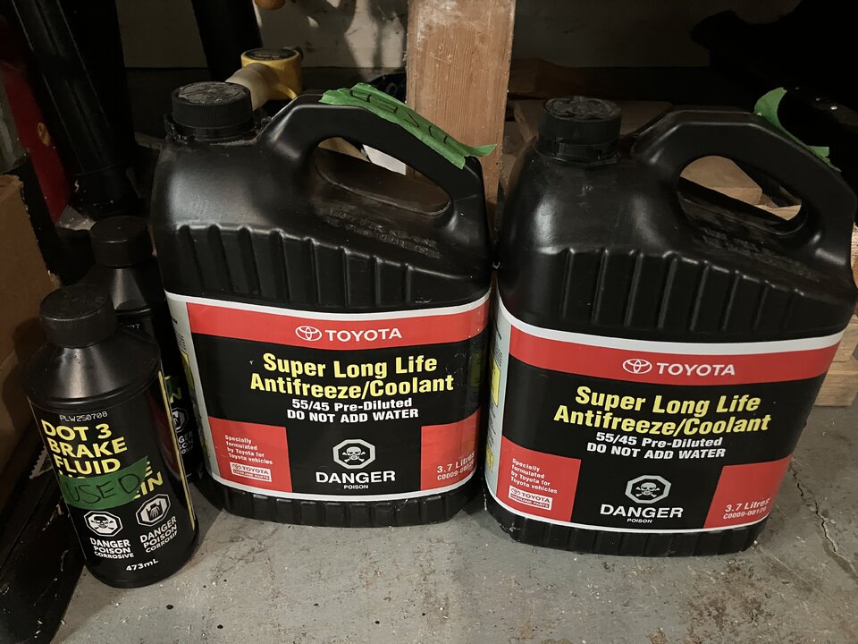

  16. Mendel Leisk
    61,574
    42,364
    Well, 50% water. Except up here on the balmy west coast of the Great White North, where it's 45% water, courtesy of Toyota Canada. Curious if Alaska gets the 55/45 mix too. Or North Dakota for that matter.
    I'd concur regarding coolant "flush", and yeah, it's mostly just a misnomer. If not, it's bad news, both for trying to subsequently achieve a 50/50 balance (basically impossible without resorting to a full-strength alternative, say Long Life Coolant, without the adjective "Super"), AND: what the heck to do with the flushed water/glycol mix, run it down the street, to the storm drain and streams?
    I just did both coolant circuits, will take the old stuff to our dealership for responsible disposal (I hope). Ditto for some drained brake fluid.
    #36 Mendel Leisk, Oct 24, 2025
    priumium likes this.
