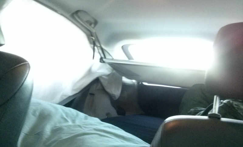

    Mine are neither black nor luxurious, but also not $169.95. I wandered into the local fabric store and picked up about 2½ yd of an aluminized silver fabric intended for ironing-board covers. I slit that lengthwise down the middle, making two strips long enough and wide enough to hang from the triangle portholes in front to the triangle portholes in back. I hemmed one long edge of each one around some thin plastic strips for stiffness. To put it up, I just shove those stiffened edges in between the headlining and the rubber door frame trim. (A little more stiffening is needed at the ends, to stick out straight over the triangle portholes, beyond where the rubber trim is.)
    When I started the project, I was going to be all fancy and cut them in curves to match the roof height, and instead, when I reached the point where they were just hanging down from the roof and covering the windows, I said, "so what if there's extra fabric hanging down front and back, it does what I set out to do," so I went on to another project.
    As you can see, it doesn't really darken the cabin in full sun as much as you might want, though it seemed ok at reflecting heat, pretty much like the windshield cover, which is a similar looking fabric. To get darker, I guess you could double it up, or spray it with some kind of pigment, or laminate some kind of foil to it, I don't know.
    I need to come up with something better for the rear window. All I was doing was unhooking the cargo cover and hanging the front end higher with some straps to the assist grips. It's not quite long enough though. It did a good enough job blocking visibility for privacy, but still let a lot of light in.
