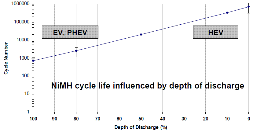

    Perhaps this would help. It is not from Toyota so, you can just ignore it. But I will say this. A typical hybrid cycle on battery is 5% depth of discharge. The way you want to use (EV cycle) is 40% depth of discharge (dod). Prius battery was designed for hybrid, not EV.
    40% dod can happen in very heavy traffic and it is reserved for those atypical conditions.
    Understanding NiMH hypercycles (to prolong Prius HV battery life) | PriusChat
